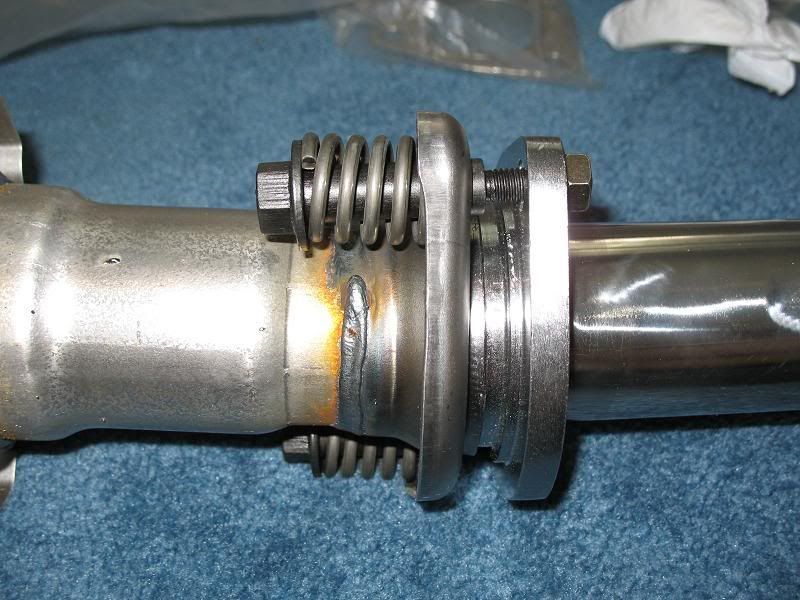

Question 1: Do I have this in the right orientation? If I just tighten it a little more would that be fine?

the stock header should slip out the bottom with a little finess and as for the new set up i would put the header in as one peice bolt it up then the cat followed by the exhaust peice by peice utilizing all the hangers then tighten all the bolts and you should be done. go front to back thats the easiest way to do it in my opinion and personal experience. hope this helps a little
