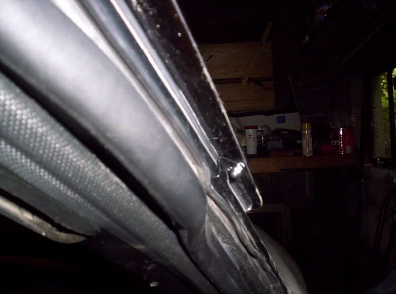

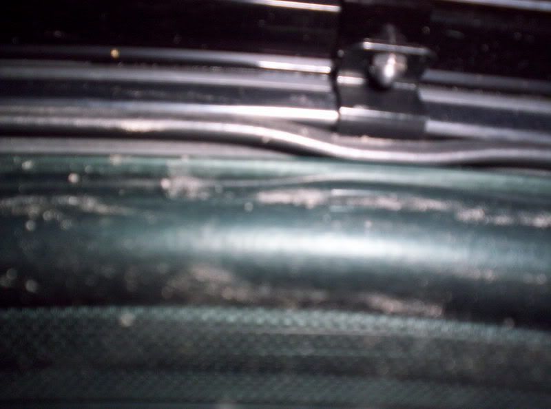

HEy gus, i just mocked up my JDM visors ( just clipped them, didnt use the tape yet) and i was wondering if this is right. it looks right, but the rubber molding is pushed out so far the window catches on it. you hafta kinda push on the glass and close the door slowly.

Now can anyone REALLY help? In all the pics i see of them installed, they all sit and line up just like mine, and the clips are holding EXTREMELY tight. Didnt tape them yet, im gonna wait till i paint the car. Its just that small part of the molding pushed down that stops the window, the drivers side window hit the molding before i even installed the visors, now both do. I have to either push on the window and kinda tuck it under the clip and then shut the door, or shut the door with the window down and then roll the window up. Or else leave the window down a tiny bit all the time.

white92LS531, the clips have to go under the big rubber strip. It seems that you have it over the big rubber strip. The tape does stick to the metal strip, be careful when lining up everything. I’ll take some pics when I get home from work.

if i put the clips under that strip thats bulging out, the window will come in contact with the clip. is that how its supposed to be?

i have my clips in between that black metal trim and the window seal. they hold tight and they seem to line the visors up correctly, however the problem with the window hitting the seal is there. i just couldnt see aotehr way to get them in.
put it this way, in one tutorial it said “if you remove the metal window trim, youll be able to see how they go in”. and i couldnt tell at all lol.

After looking at mine and now looking at yours, I think that you got it right.

hmm i guess maybe i need to adjust my window. i looked at it today though and if i adjust my window any more loose there will be a gap between the window and the outside seal. ill probably just tap my window switch and leave them down like a centimeter.
