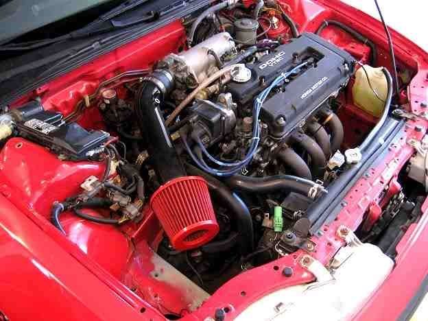

So I found a 92-95 civic si intake pretty much a d16z6 so a civic ex one too. It looks like this,
With no battery in the engine bay it seems it follows the same first bend as the stock pipe but continues at an angle instead of curing left to get around the battery.
My guess is it would be somewhat like this If I am correct? Now I know that car has no abs but it looks like it would clear the system.
