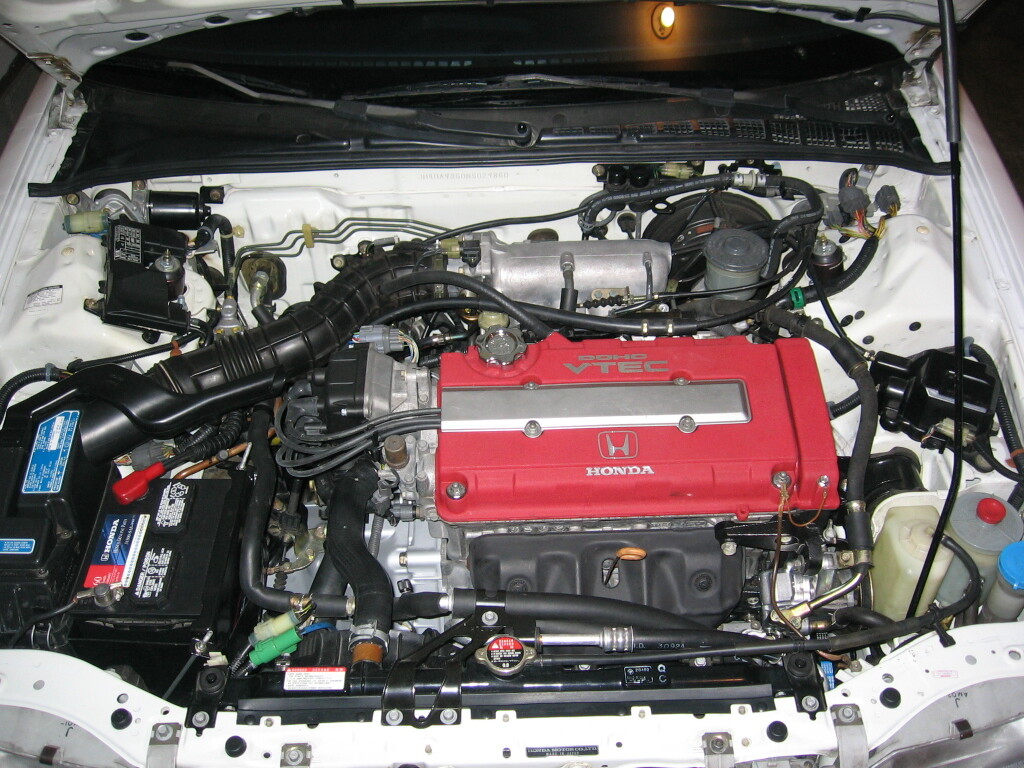

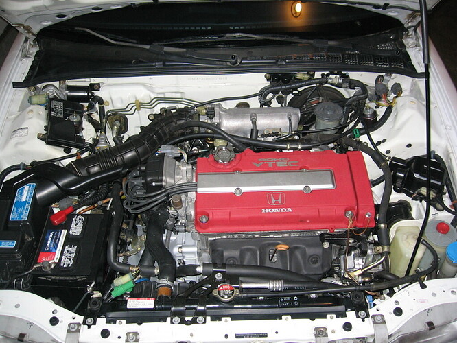

so Im kinda stumped since I already have the motor and tranny in but my driverside axle keeps going bad and maked the entire front jump or viberate… Im sure its has to do with the driver side mount or braket so I need a pic of the braket im supposed to have. right now I have this wich was installed by the guy that did my swap…

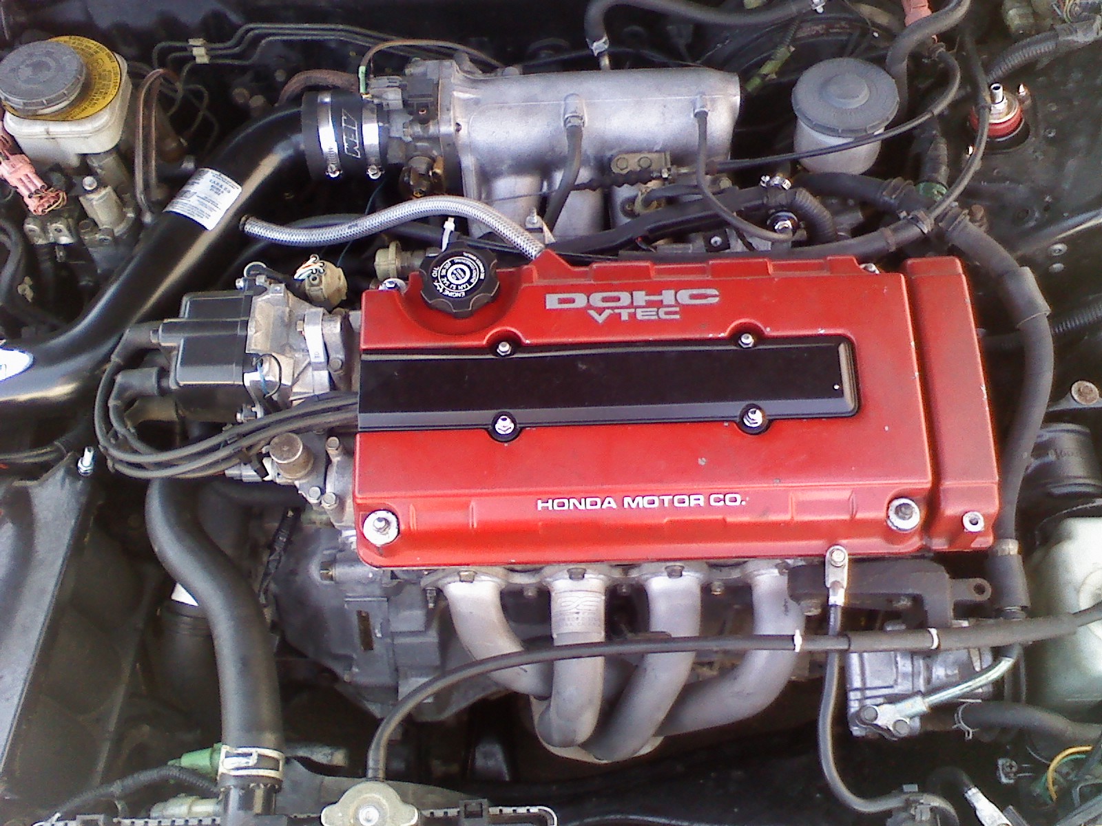

Okay I have a 92 GS with a JDM B18C(R) in it with the JDM S80 hydraulic transmission. The previous owner paid to have the swap done by some local shop, I bought the car because it was a deal I couldn’t let pass by. After I bought the car I bought the 3 Hasport mounts for it because the stupid shop just twisted and mangled stock mounts to get it in and the whole lump was shifting around when you got on and off the throttle, it was really really bad and when I swapped my mounts I found out my stock rear mount was cracked hardcore. There is no front mount when you use a hydraulic transmission in a DA thats why I said 3 mounts… Anyyyyyways here are some pics of my driver side mount. It looks to me like your engine is site too far forward, like too close to the rad support and it should be back more towards the firewall, compared to mine anyways. What rear mount bracket are you using?
Here are the pics:
well i get that you used the gsr mounts for your 92 but since my 91 da6 was never ment for vtec so i assume im supposed to use the same year factory brakets and mounts. What I dont know is if the mounts I have now are the right ones since the shop replaced them without telling me.
Im sure im still useing the factory rear t bracket since it wasnt on my old motor… dude at the shop told me he reused it.
