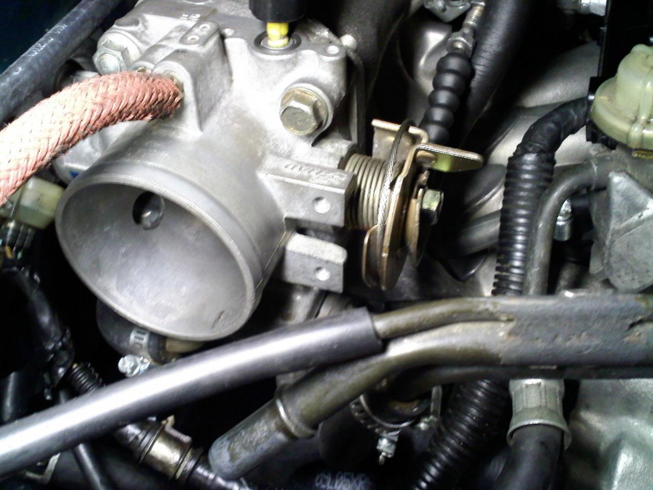

Also Im having trouble hooking up the throttle cable because it looks to short? and the bracket from my old one don’t fit the new one.
Got some pics if maybe would help

i’ve doing research for days and it seem i might have to put my auto TB cause of the cable
anybody know about the throttle cable?
throttle cable i believe should be fine, but to check pull the intake tube and be sure the throttle plate is completely closed. if it is then the cable is fine

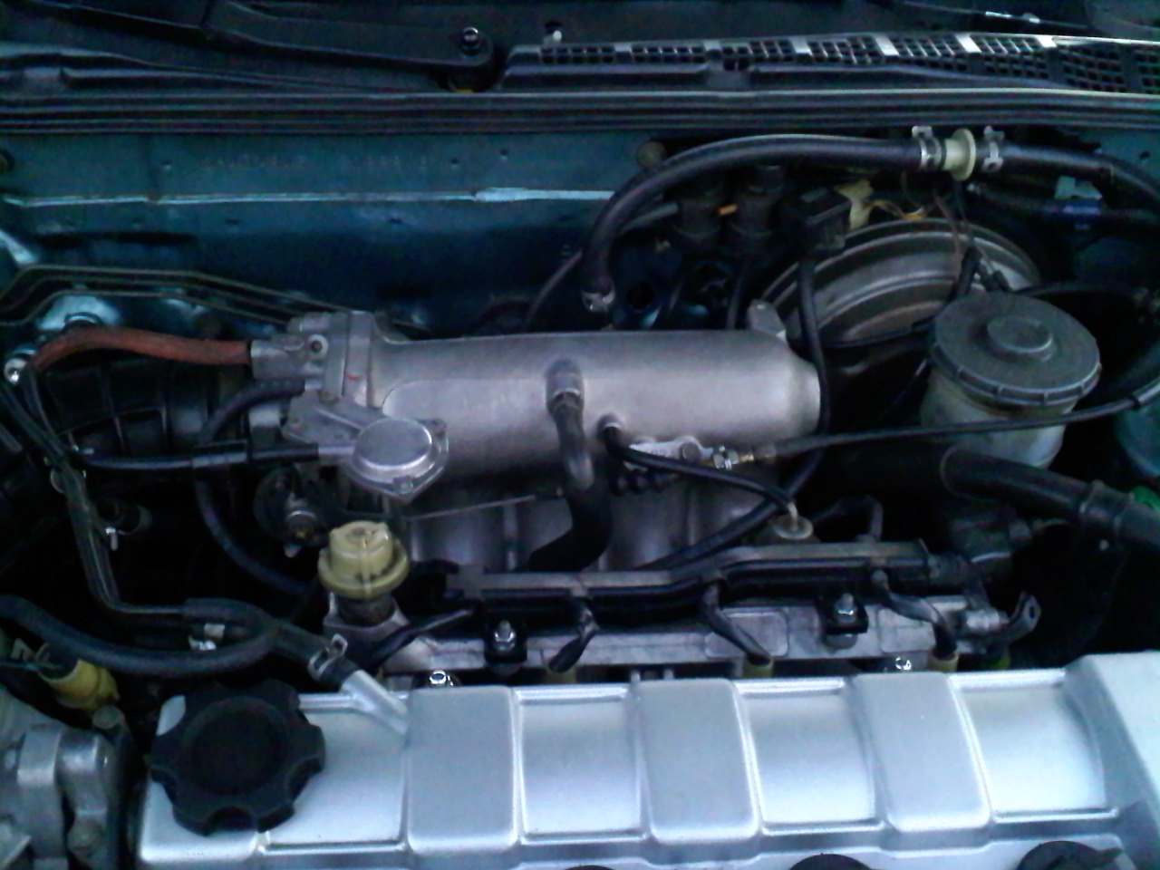

Finished
Alright guys thanks for your input! my car is running beautiful.:clap: Thanks for advice about the TB being different made a lot of help would never of thought about it. and also the 94 TB wouldn’t close all the way not sure why?!
Got a pic for the end result.
Was it worth it? After fixing the hight idle yes it was!:slight_smile:

Did you switch the head AND intake? I’m just asking cuz of the b18a valve cover. Do you feel any difference at all?
No i switched the TB’s because the gasket i broke and made a leak and because i didn’t have the MAP sensor so it make another vacuum leak. And i was getting frustrated so just put the old TB.
I got a different throttle cable from the pick N pull cause i ruined the threads on the old one! lol
And as for the head i do have a b18b but did not put it on yet because got some plans for that down the road.
