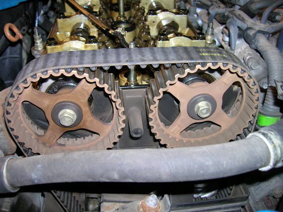

Are you sure the Timing belt is good and the cams are in time?

timing belt is good

i dont know how to make sure the cams are lined up

as for timing here is a pic:
i donnt know much about timing but it looks like thats lined up enough to make it run
