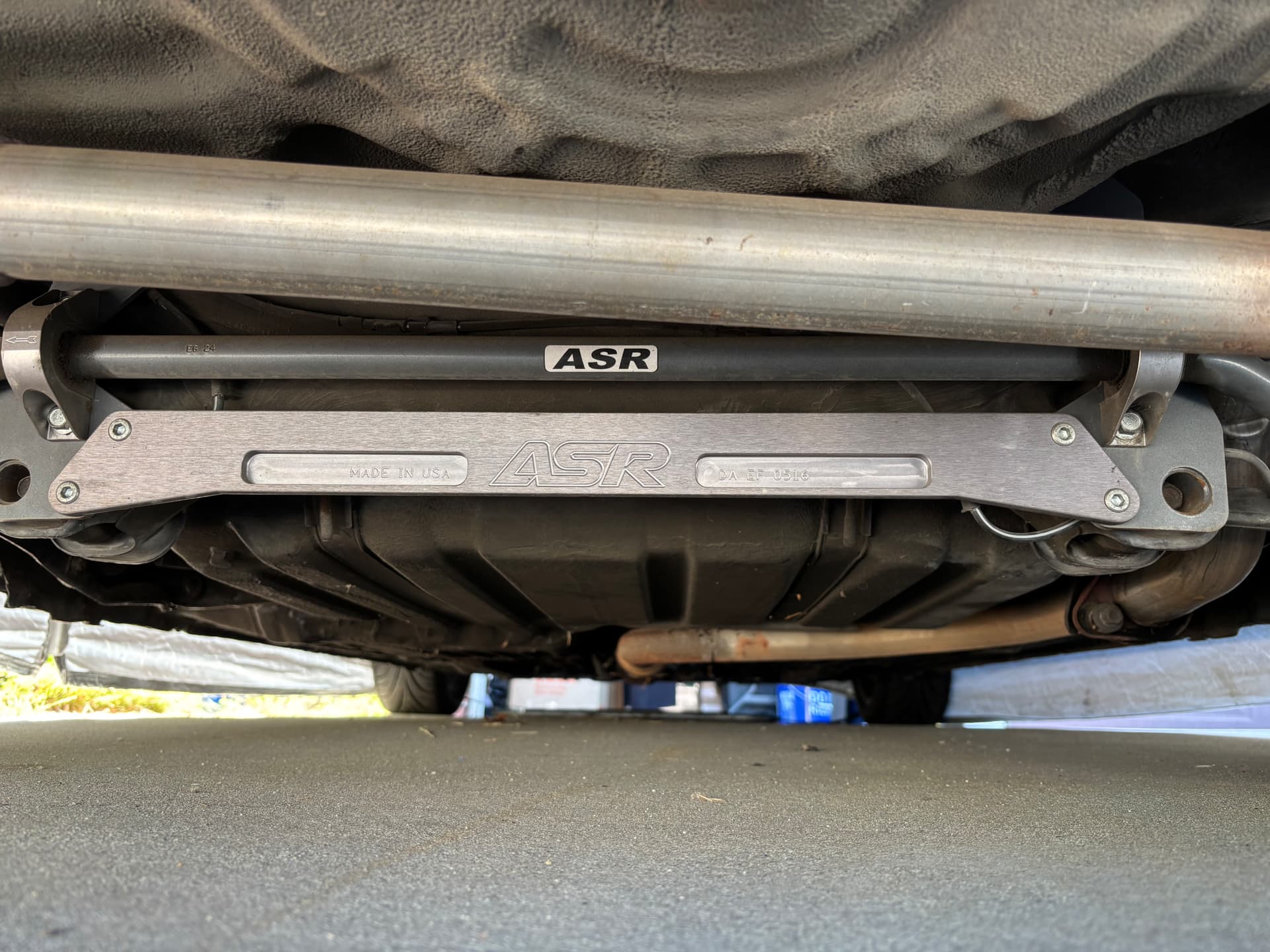

So after the front and rear camber kit , next upgrade would be the stock rear sway bar kit. This time I chose ASR , I heard good things about them so wanted to give it a shot . Man what a day and night difference. You do have to drill four holes inside the chassis that bolts up to the ASR sway bar bracket , aside from that everything is R&R . Make sure you measure twice before drilling!

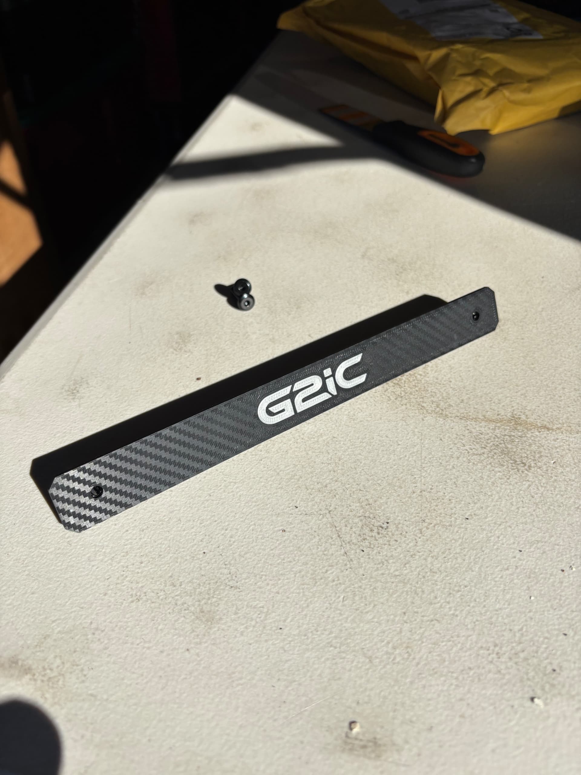

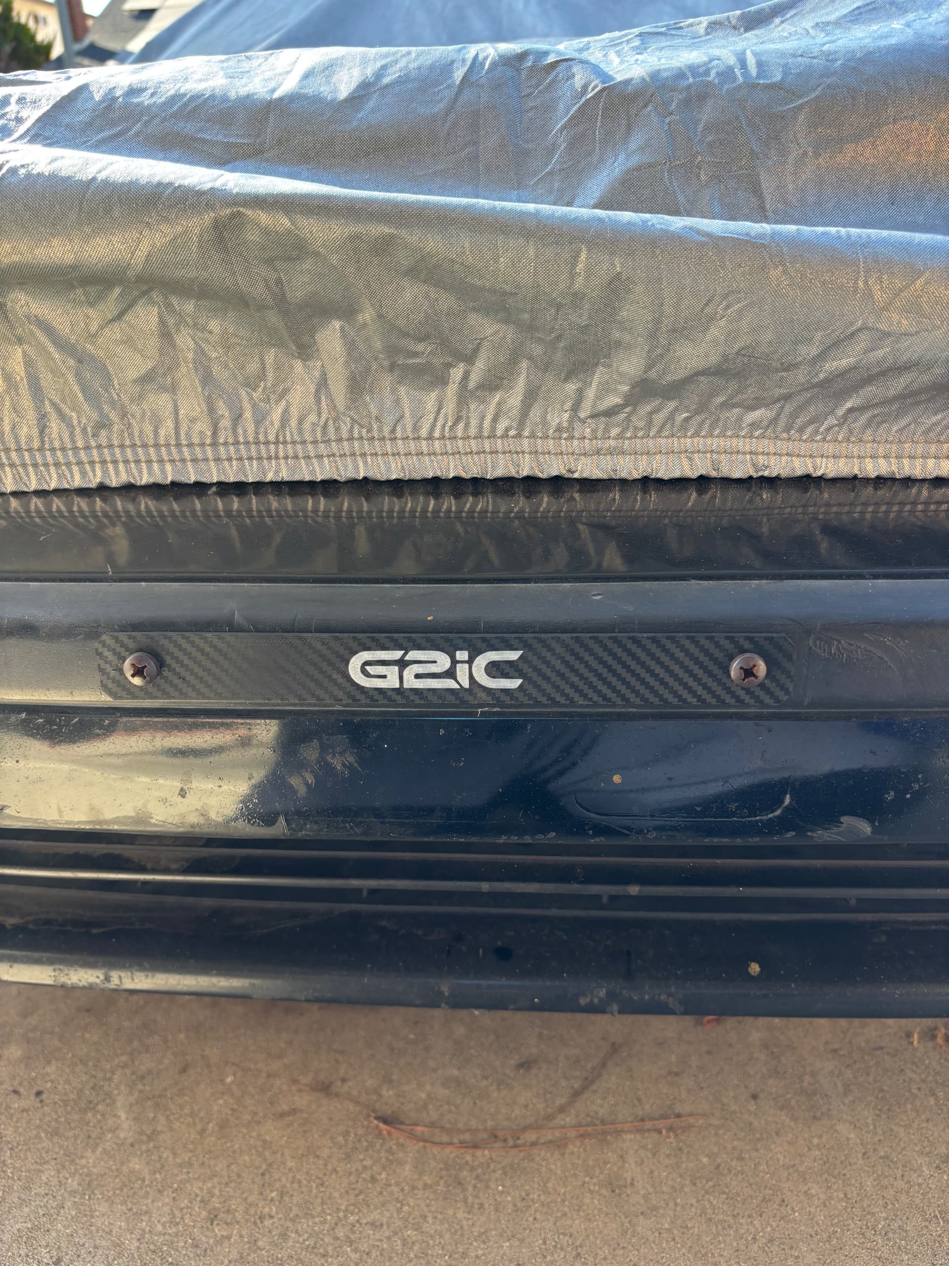

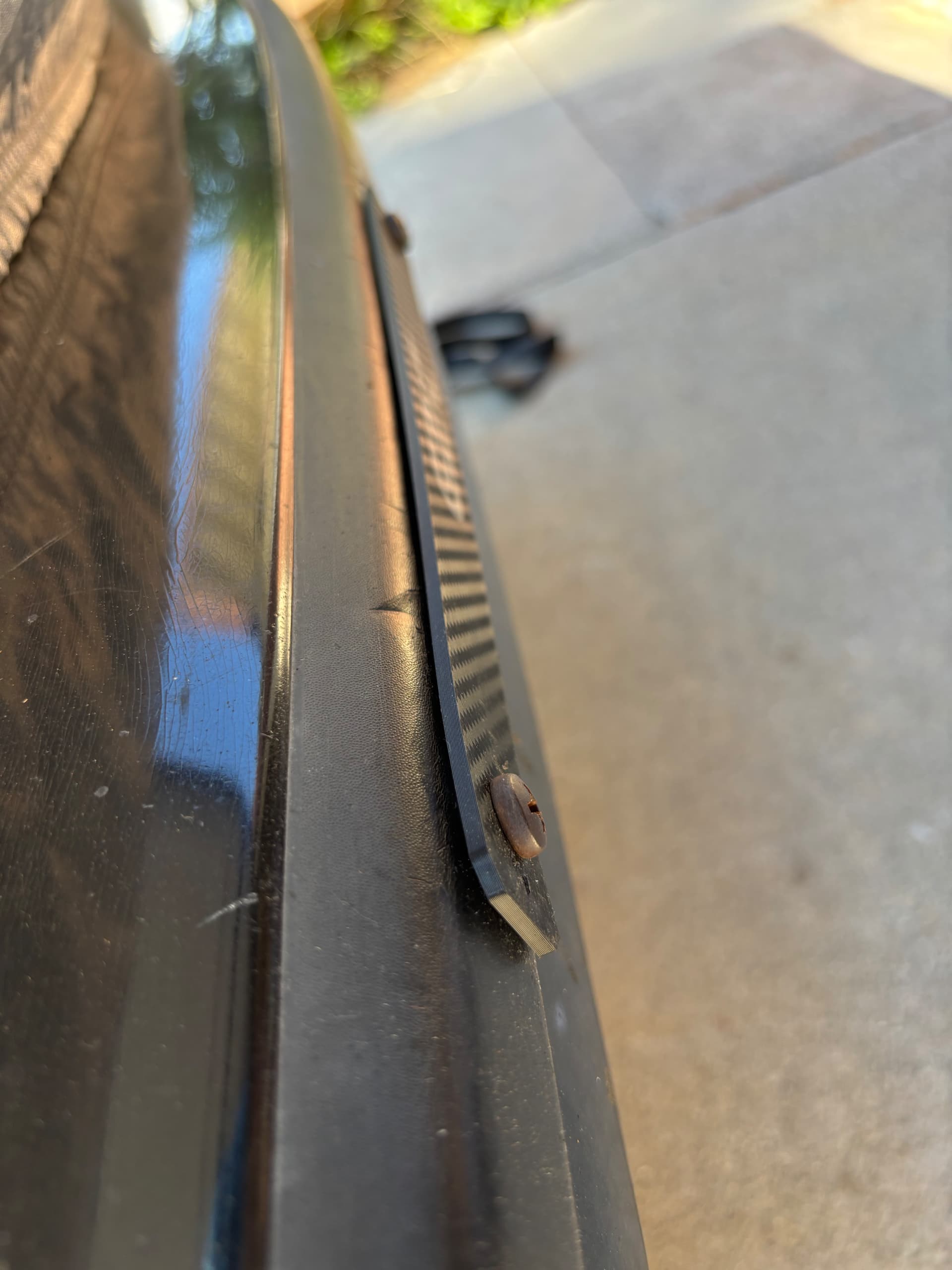

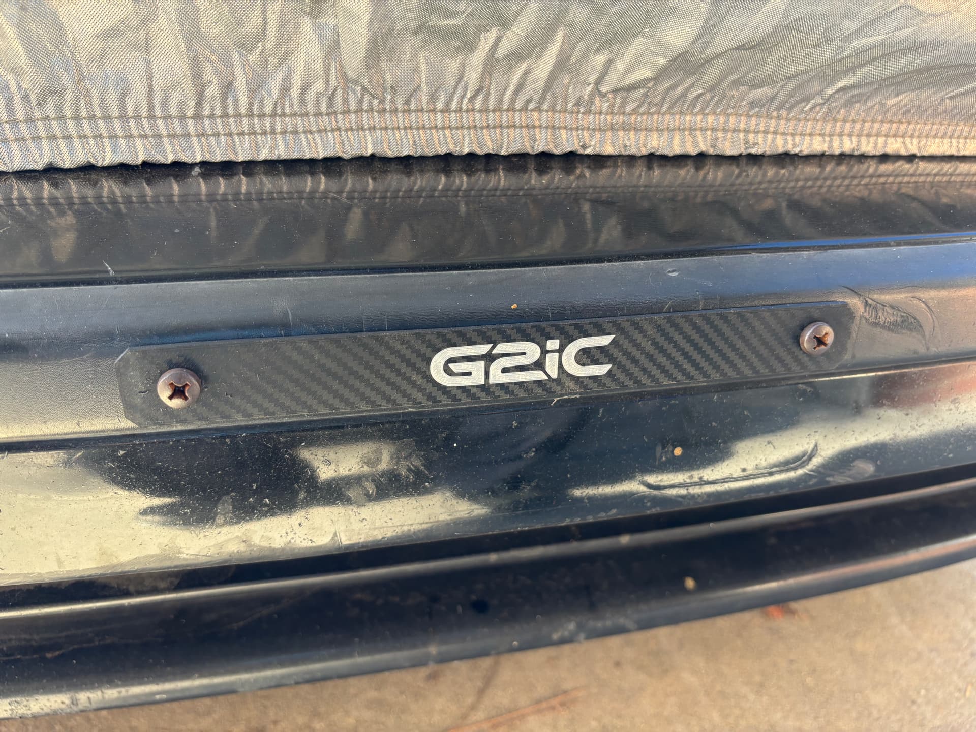

So today I installed the front bumper cover a product from G2IC ,I used the two outer holes that lines up with the cover here the result. great product! Love how it looks and get to represent G2IC ![]()
Didn’t know this existing might need to grab one!
