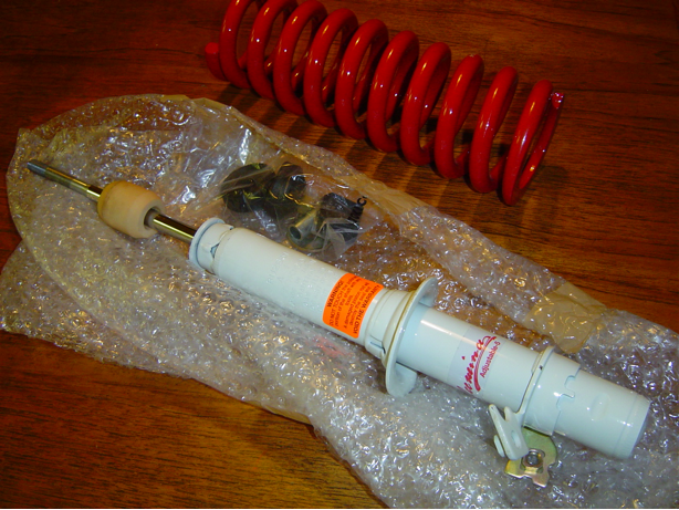

update: the shocks came in (pretty fast too, shipped on monday)

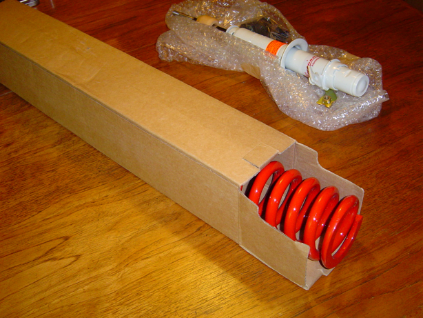

one concern my dad had upon opening the package (i am in my irvine apt, my dad is at my house. he sent me pictures of it) was the somewhat disheveled look of the packaging as if it had been opened. There is some dirt on one of the bump stops on a strut but everything else is immaculate despite the packaging. On the outside of the box someone scrawled “Refused- DIdn’t want” and what looks like to be a date 3-27 -xx (picture cut it off)
here’s the strut:

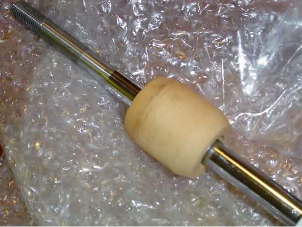

you can see a slight dark ring on the bumpstop and my dad said it felt kinda greasy. but other than that the strut seems more or less new.
here’s the spring with inconsistent packaging. One spring is in a bag, this one wasnt.
closer shot of the bump stop:
is that normal? the shaft looks pretty clean though.
i have a feeling the person opened it, realized he didnt want it and returned it. I’m kinda iffy on these kinds of things, but is a small amount of dirt on teh bumpstop normal? obviously the packaging has been tampered with…but the springs from the pictures look clean and untouched, and the baggie of parts there looks to be sealed.
i’m going to give them a call tomorrow and ask about it. It was advertised as “new in box” so what do you guys think i should do? how do struts come packaged from the factory?
i wouldn’t worry about it. seems like your a little paranoid haha. the shocks seem new. nothing looks wrong with them through the pics. you can give them a call like you said to make sure.
