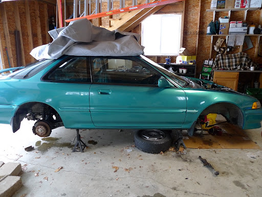

Alright. Let’s get this engine out of there:
There we go. Immaculately clean:
And let’s get rid of that pesky ABS while we’re at it:
And the interior wiring too:
Remove front suspension:
