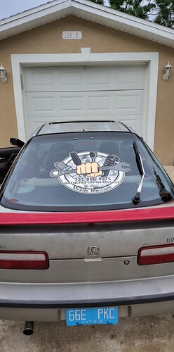

Also, are you in FL? I’m recognizing the plate type.
I mean I can let it idle for hours and it doesn’t have a problem and yes I am in Florida I’m in Pasco county The issue occurs when I take it for a drive it drives fine until I let go of the gas and then it will die and then I can start it back up and it will start right back up and run fine put it back in drive and it’ll drive completely fine until I let go of the gas again and then it acts like it loses all power even if I try to give it gas it just bogs bogs bogs until it’s completely slowed down and dead
