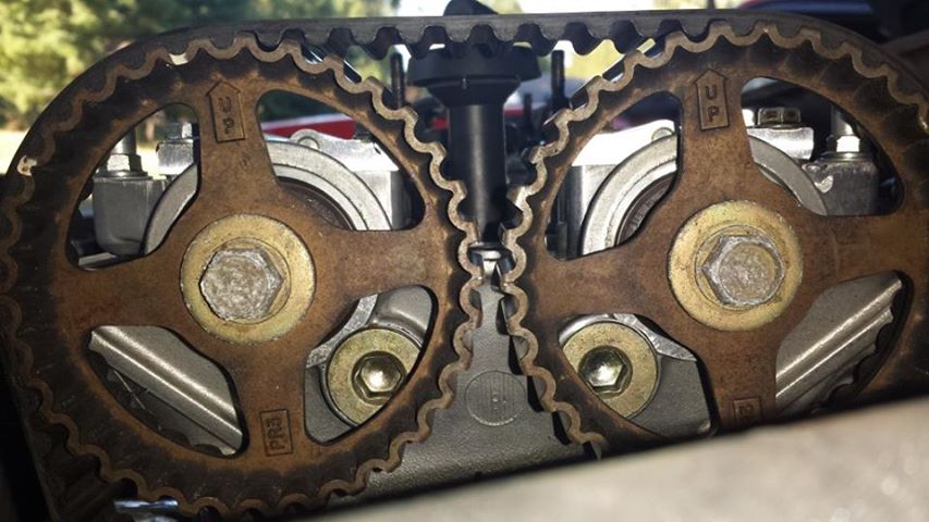

I’m looking at my timing at TDC on the crank. Keep in mind this is an LS/V so some slight degree offset is expected. Does this appear to be a tooth off to anyone?
We can’t tell if it’s off because your PS hose is in the way…
Was the pic taken with the #1 cyl at TDC? Or was the pic taken when the notches on the cam gears lined up? If your answer is YES to both of those questions then your mechanical timing should be fine.
Lined up at TDC on crank pulley. Here’s a better picture:
Personally I like to use the screwdriver in the cylinder trick so I can watch the cylinder position at the same time as the cams. It looks within spec to me though in the new pic. They aren’t perfectly lined up but if if you moved a gear one full tooth it’d be more than that off. With that said, it does look like both cam gears are slightly counterclockwise of where they should be, but it could just be the angle of the photo. The motor sits slanted in the engine bay, so if the car is on level ground the engine leans forward a little. The cam gears should be parallel to the engine not the body. So they will point UP and be perpendicular to the valve cover and not perpendicular to the ground.

I don’t think the belt being off a tooth would cause one cyl not to fire properly like you’re having issues with. Everything would be off a little, not just one cyl off a lot. But that’s just a guess, I’ve never tried it so don’t know for sure.
That’s what I thought, even if that were the case. The logical problem would be CYL 4 not firing either.
