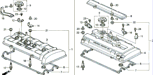

replace your spark plug gormets(seals), and while the valve cover is off, replace the valve cover gasket too.
#7 in the picture, you’ll need four of them.
Definitely spark plug grommets like spikeymike said. Definitely NOT the head gasket.
