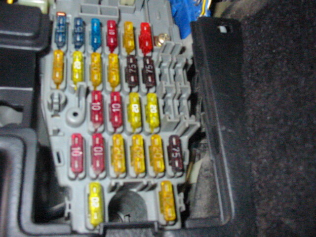

Does anyone have pics of their fuse box on a 90 teg. Need to find out whats missing. I have had this car for 4 years and had a problem w/ my taillights going off and on. Last week took fuse box out and fix problem but the previous owner had a jumper wire where i think should have some kind of link or relay there.
take a picture of ur fusebox and post it and we’ll tell u if its suppose to be there or not…
cool, ill do it first thing tomorrow. thanks
what goes at the top right, next to the orange fuse. Right where the screw is. please be specific. I know a fuse or fusable link or something.
main acc. fuse…40amp i believe…it screws in…im guessin ur accessories dont work rite now?
thanks alot. it all depends on what acessories.whats not working is my hazards,and my blower,that ive notice.im about to go get one. i appreciated it and i’ll let you know:bowthank:
went to autozone and the computer says it call for a 70 amp so i got it and put it in. everything is cool now except my hazards still do not work. :think: any ideas.
check the hazzard fuse in the engine bay fusebox
be careful, i agree that it is also a 40 amp fuse.i have personally replaced two of these.
yes, i agree. it’s a 40amp fuse link
