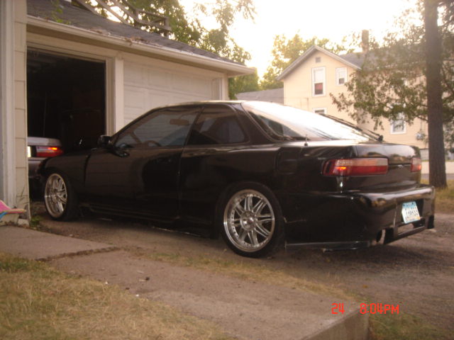

I have a couple Problems I will Start with the Tranny. I have a 92 LS with a B20 I bought the car about a month ago an i liked hondas untill i got this. On my way home from geting it i broke a cv shaft not a big problem easy fix. But after i picked it up on the highway it kept on poping out of fifth gear so i said f it an just left it in forth but my ? is what is causeing that the tranny is supose to only have 45k miles on it. It dont grind in any gears. Problem #2 when the car is siting not movind if i rev it up to around 3500 rpms i hear a vibrating that starts in the front an vibrats back through the shifter?
An the last problem is i have the car sitin in my drive way an i dont drive it much but if i go to start it an it has been sitin in the sun with the windows up it wont start no fuel pressure on the gage. But if i roll the windows down an come back in a hour it starts right up no problems?
I think i payed to much for this car it is nice but needs work i payed 1700 for it. It has a wide body kit on it but need a front bumper an has a nice paint job black with gliter like flakes in it
