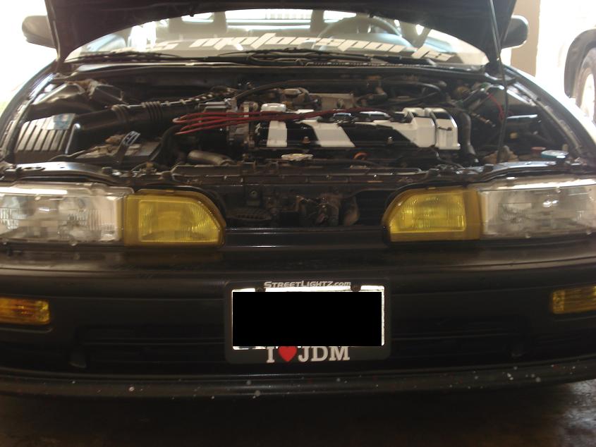

Only engine bay shot (closest one)
solconviction- OEM JDM B16 P30 pistons .25mm over, acl bearings, 8lb flywheel, ferrea stainless flat face valves, type r springs and retainers, polished ports, port and gasket matched to intake, and all new gaskets. It runs great i love it. I am going to get either skunk2 or crower stg2 cams for it soon now that it’s broken in. I would also like to slip in a thinner head gasket to get it up around 12:1.
Nice! Sounds like a nice refreshed B17…keep us updated, I was also thinking about the Skunk2 cams and was curious how it would be with your +/- 12:1 compression and how the idle would be…Great work!

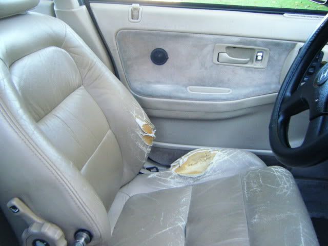

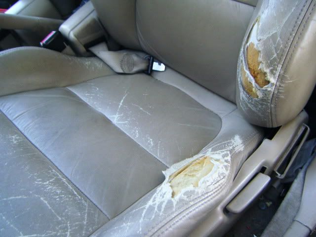

INTERIOR driver seat before

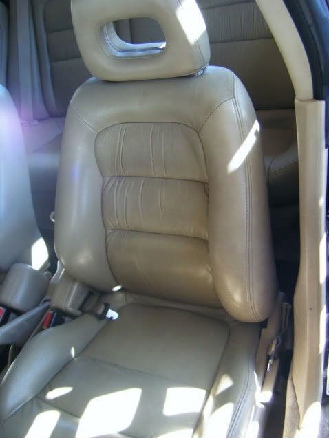

after
man its hard finding clean tan leather seats for the g2(took me 2 years and finally found a set)

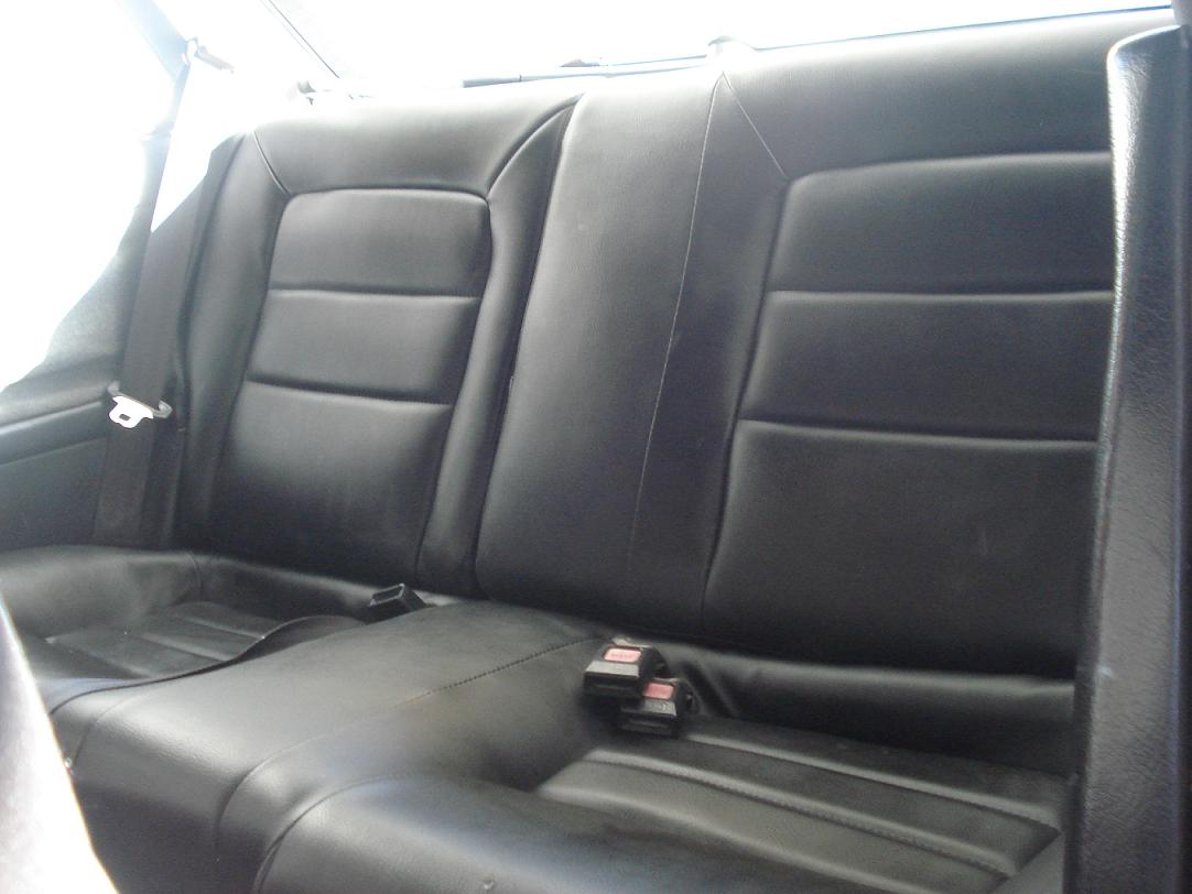

RANDOM INTERIOR PICTURES…
took the extra headrest and swapped it out with the rear head rest

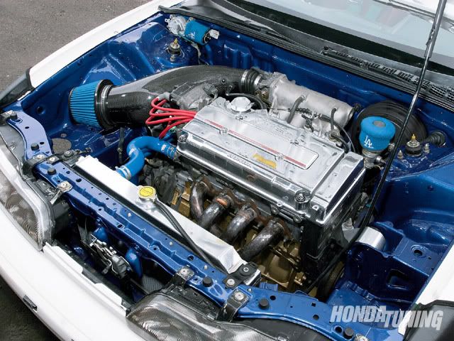

heres a few of mine
why no more purple bay?
yeah still purple, guess the lighting or editing made it look blue, love the way blue looks. going back to white soon when i have time to pull the motor out, always working and have to spend time with the wife and kids on the weekends…
how come your gona spray it white again?
