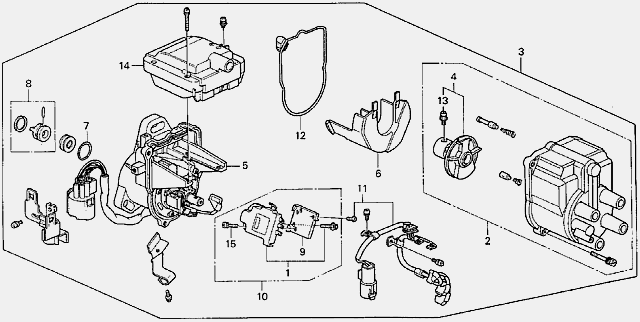

take your ignitore in autozone to get tested. chances are its your ignitore.
half twisted
ok i have worked on cars for a long time now and i even have heard of some really off the wall parts , i even saw a part called a muffler bearing (if you work on farm or heavy equipment you’ll know what it is) but what part is a ignitore? and how does autozone test for one ?
i think he meant igniter… item 10 in the diagram
