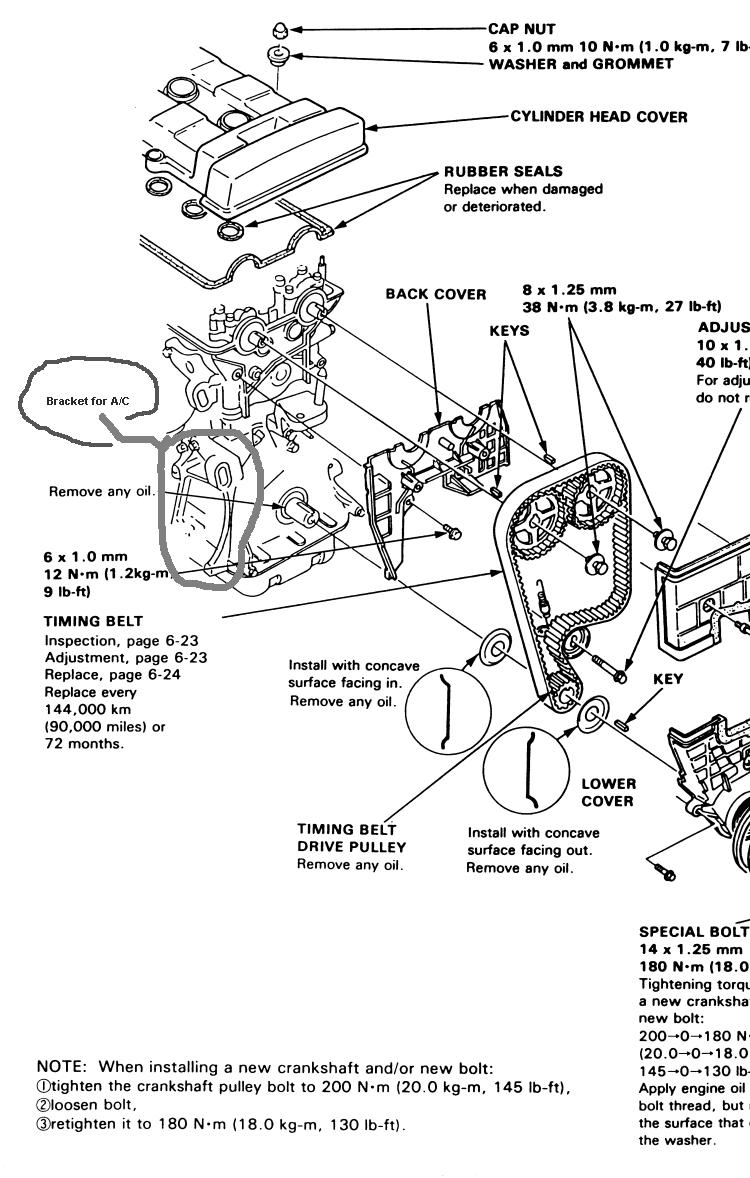

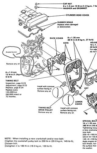

I need the whole tensioner setup in between the A/C compressor and the other pulley. I dont know what this looks like but the shop said mine is missing after I spend 110 bucks upgrading my system. I cant find it in the yards, so let me know. Hit me up at the email listed above, or I just check on here too. Thanks.
A/C tensioner
Toaste:
I just removed the A/C from my car. The compressor needs charged if anyone wants to buy it. I’ll drop it cheap. Anyways… Toaste, I have the bracket and tensioner for the A/C if you want it. I can ebay it and send you the reserve price or whatever. I will sell it cheap.
I highlighted the bracket on the Vatozone picture. It is the only one I can find. the piece is a swuare bracket with a pulley on one corner.
