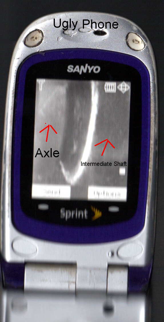

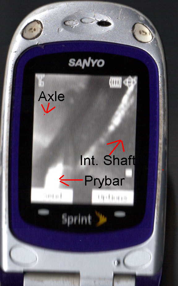

Here’s 2 pictures…yes I scanned my phone with a scanner, sorry its the only way :smiley: but seriously if these aren’t good enough I’ll try to get better ones. First shows the axle and intermediate shaft, second shows where I am sticking the prybars, screwdrivers, etc. But the gap between the two looks bigger in the pictures then in reality. The gap is just big enough to stick the prybar into.

OH MY GOD THAT IS AWESOME! I can’t believe you scanned a picture on your phone.

I’ve been trying this for a few hours now with still no luck. Whenever I put a lot of pressure nothing happens, and I’ve started to bend the ring that looks like it joins the two shafts (the ring to the right of the prybar in my second pic). It just ain’t coming out!

the lock ring is probably siezed. not necessarily a huge problem. i had a cold chisel laying around (1") and it was thick enough that it just barely fit in the crack between the two. i started off hitting VERY VERY LIGHTLY and increased the force of the blows (2-pound ball peen) until the two separated. it didn’t take a lot of force with the hammer and thick cold chisel, but all the prying in the world wasn’t budging them. as soon as the chisel was able to force the lock ring out, the axle pulled out like buttah.
