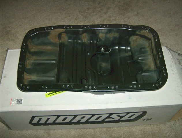

ok so i finally got an oil pan today
anyone know what i can use to clean off the brown stain? now all i need is a gasket and torque wrench, and what drive size for the torque wrench? sorry for the newb questions.
thanks
simple green is pretty freakin good at cutting out greese and oil. and for the torque wrench. use a 3/8 inch and torque the bolts to 108 in-lbs.
