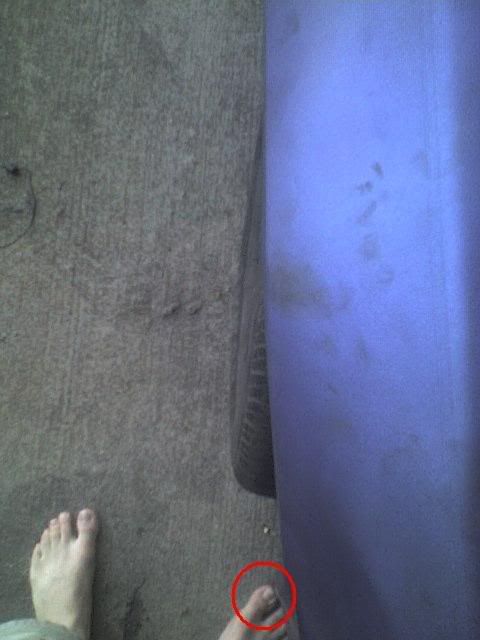

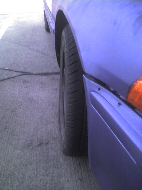

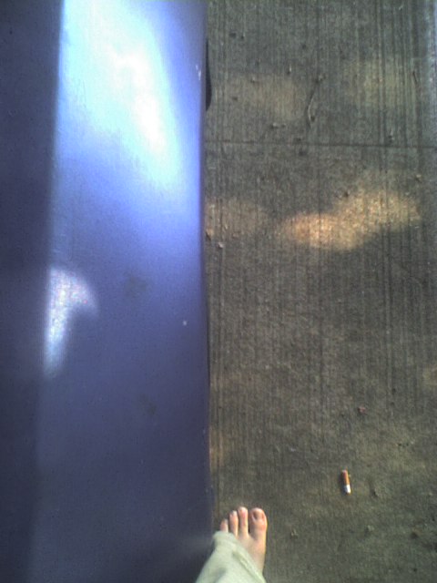

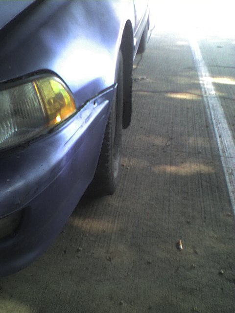

I have a 1992 Ls 2dr the right side tire is bent out and when i drive it, it dont like to drive stright it pulls both to the left and right and sometimes the wheel with stick and i have to yank the hell out of it to get it stright again, here are about 4 pictures 2 of the right side and 2 of the left side
Looks like the toe out is out of wack on the car. If thats the case a wheel alignment will take care of that.
have you done an alignment? The shop will not do an alignment if something is bent or broken so they would usually tell you what it is and if u want to fix it they can do it or at least you now know what it could be.
From the look if it I would have to say that your outer tie rods are adjusted way too much outward nor someone installed a tie rod from another car.
Front tire sticks out is becoz the tie rod is adjust too much in (as in adjusted shorter).
If you want to tackle the problem try to go under the car and look at both side of the tie rod that connect to the hub/knuckle that turns the wheels and look at the treads base of the driver side one count and see how much it is and then go and do same to the passenger side to perhaps bring ur tire close to spec then later go get alignment.
I say check under there and see if both side same length or at least nothing is wrong with the nut Or bent rod. Otherwise go get an alignment and see what they gonna say about it. They will not charge you if they cant fix it.

I circled your problem in red, looks to me like your toe is out of whack.
lol wow thats some horrible toe. if you dont have access to an alignment and need to fix it yourself you fix it by adjusting the steering arms and by the looks of it yours must be bent.
im gonna be serious now…it looks like you have some MASSIVE toe-out.

yea ur pass. side suspension is f*#k up… i would suggest getting a factory service manual or downloading one off of hondahookup.com and figure out whats wrong… gl
RiccyLSR well i did that and it fix it just need a 2 wheel alignment and hope it get better
