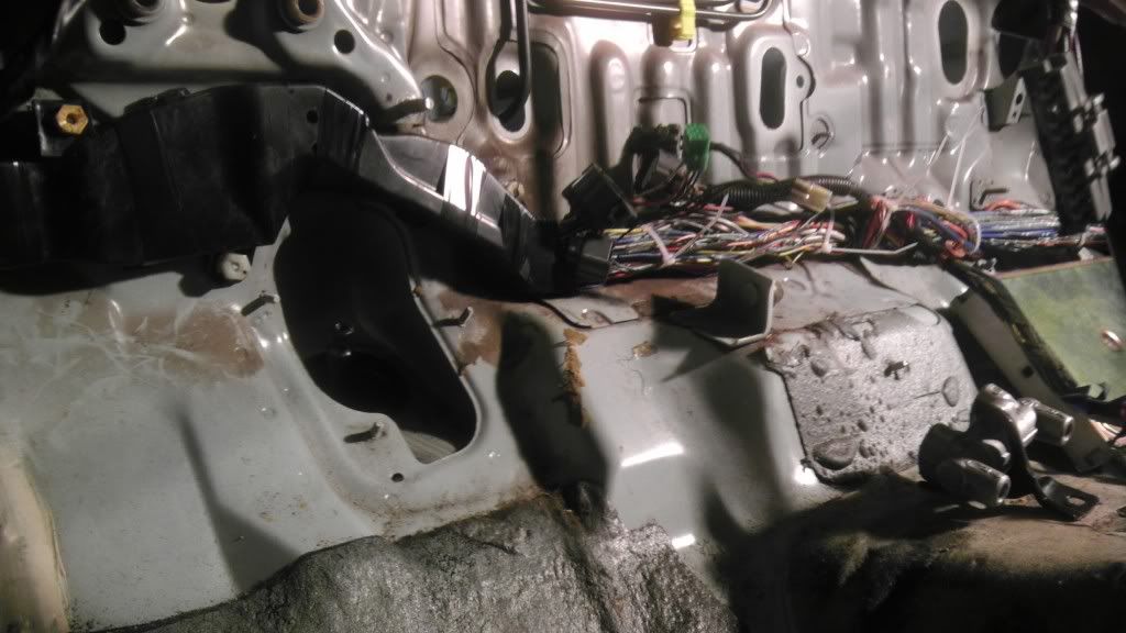

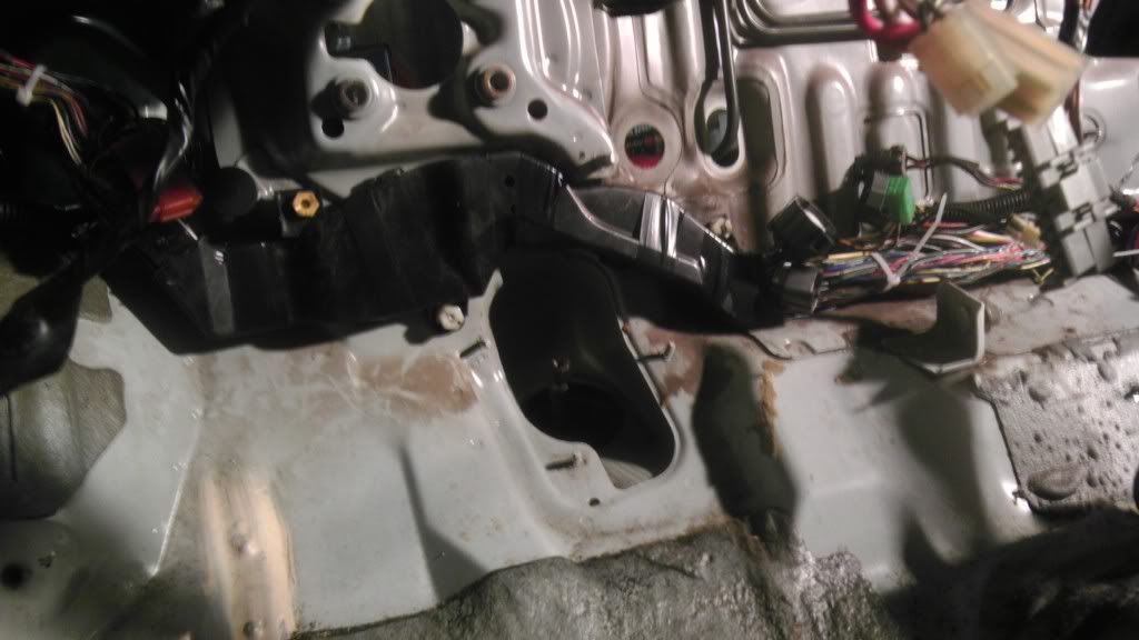

I havent cut the hole yet. My welder isn’t working right now and I’m going to need it to finish off the hole the way I want to so I’m just working on the inside and outside of the firewall until I can get the parts I need to fix my welder.

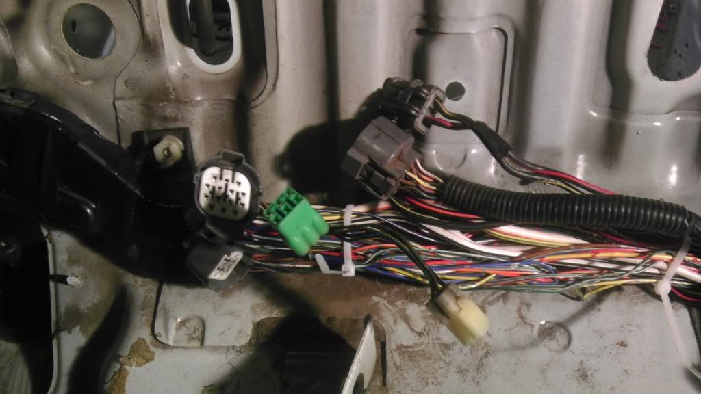

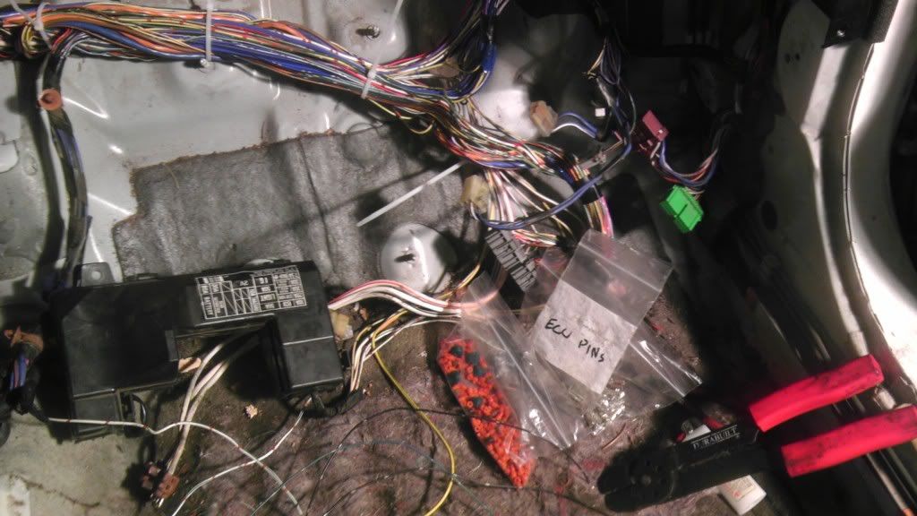

More progress today, still working on the wiring. I took aftermath’s advice and separated out the driver’s side engine harness wiring. I didn’t get much extra from doing it but I did manage to fit everything through the channel under the pedals.

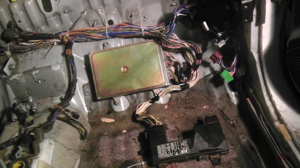

Got all the wiring pulled to the middle, separated out and organized
Then added my VTEC wiring from ecu to engine harness
Getting there!

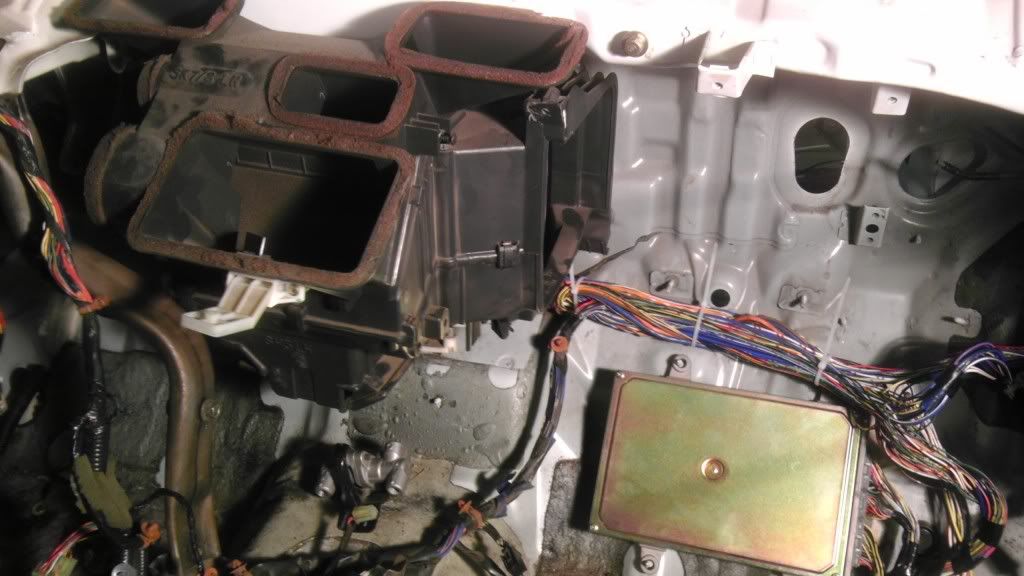

Then I mocked up the heater core to make sure the harness was going to work in its location. It WOULD… But It’s such a tight fit that I’d never be able to disconnect the engine harness without pulling the heater core so I have to shift the passenger plugs to the drivers side a bit more. Minor problem and won’t be difficult to fix right now at all. :up:

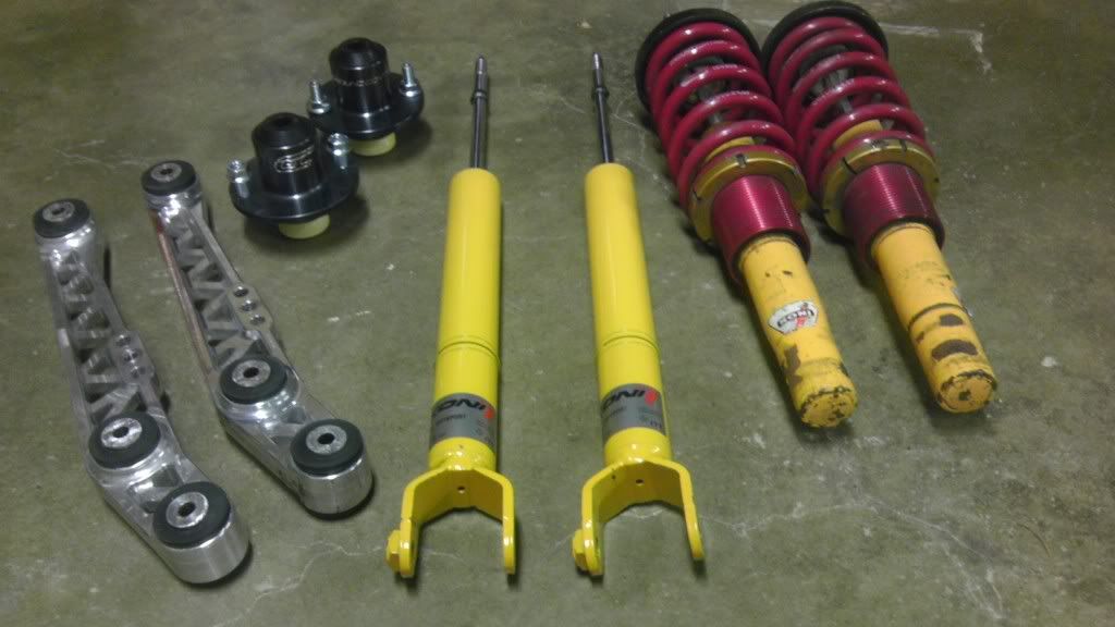

Also just bought some front Koni’s with GCs tonight!

I bought Dan’s (g2guru) bnib rear koni yellows, and now straitryders front (he said barely used) konis w/a pair of GCs. The spring rates on the GCs are 380 so I’ll probably put them in the back and try to pick up a pair with a spring rate of 450 for the fronts.

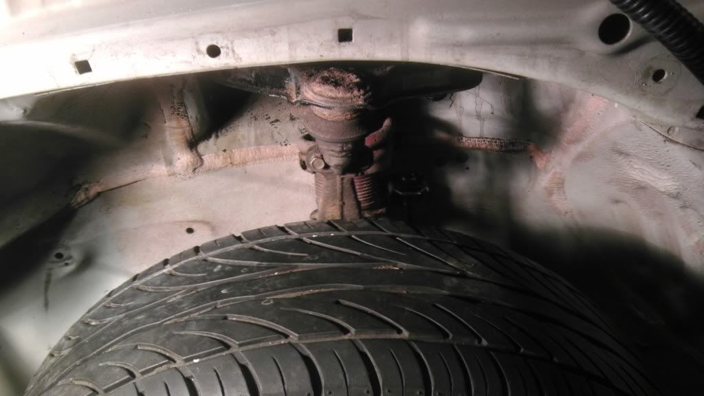

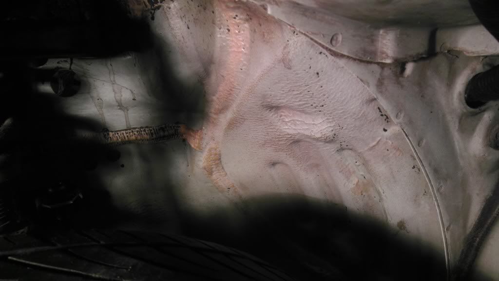

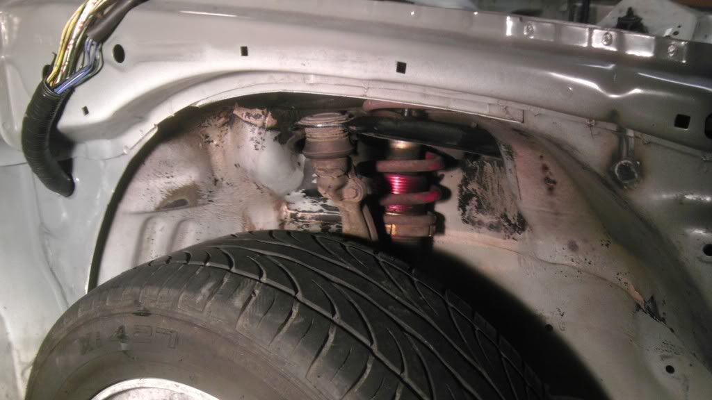

No major update today but I cleaned a ton of grime out of my fender wells. Figured I’d look at how I’m gonna run my brake lines even though I’ll still need a few more fittings before I can plumb it all in. I’ll be cleaning the areas I can’t reach once the suspension is out for rebuilding and using undercoating on the entire fender wells. All in due time though, gotta finish the bay first so I can have the undercoating working as protection for the back side of the welds on everything I’m shaving. Wish I took before pics, they were nasty!

Wheel wells lookin good sir :wink:

And thank you! Not done with them yet…

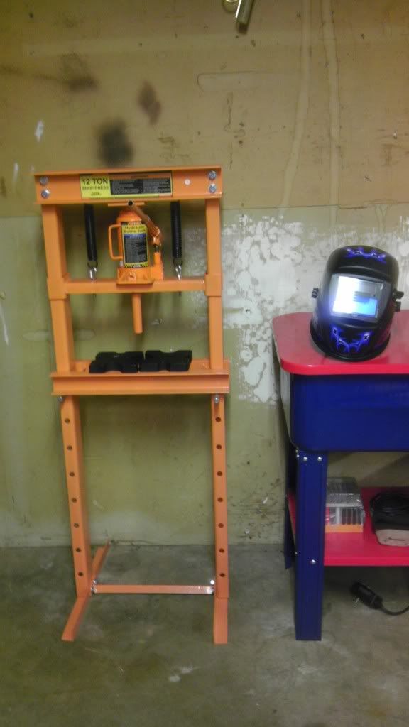

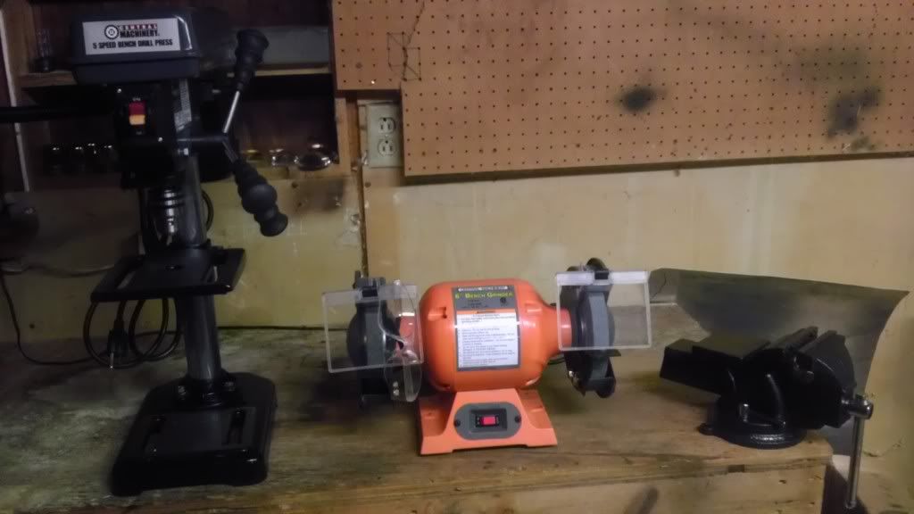

My girl hooked it up this year! She gave me a hydraulic press, self darkening welding helmet, drill press, and a bench vise for Christmas. Even though she gets frustrated at how much time and money I spend on this project she does know how important it is to me and she is really great about it. Now that I have this press I can get my suspension apart and back together!

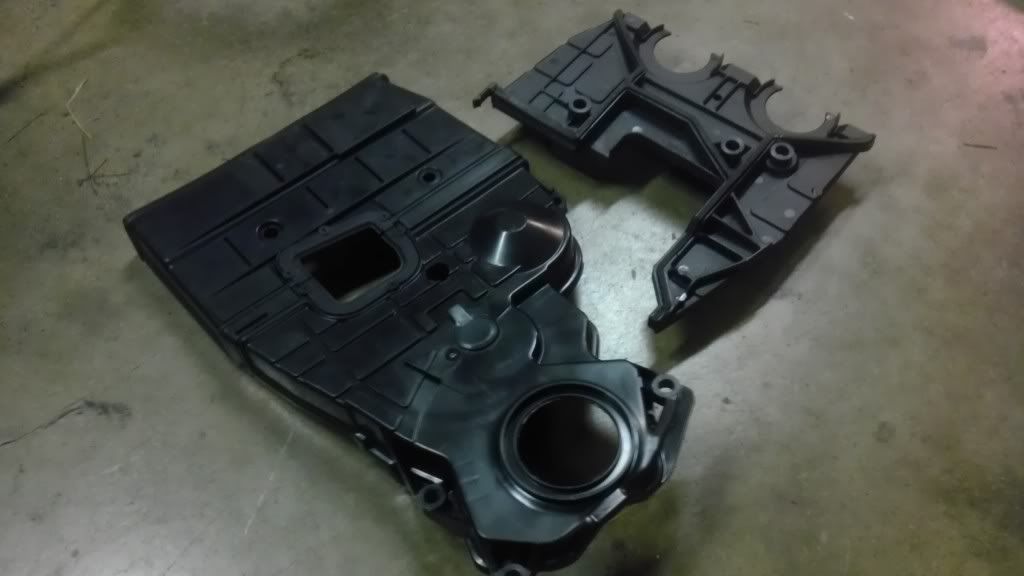

And I got some parts today!
