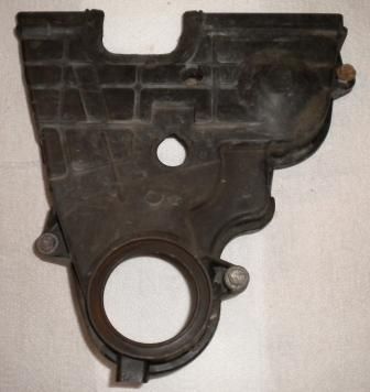

On this oil pump you don’t have crack sensor
http://i50.photobucket.com/albums/f315/JerseySiPOS/OilPump_ITR_1.jpg
You can see that this one has the space for the sensor to be mounted with a 10mm bolt. IF you look at the design/shape of the border line you can see that they have different shapes on both oil pumps. All new ITR/GSR oil pumps come with the sensor mount, so just make sure your lower timing belt cover is for the oil pump that comes with the sensor location.

I don’t know 100%, but I think the only difference with the OBD2 pump is that it can accommodate the crank sensor on OBD2 cars. But I’m not sure if you can install an OBD1 cover on an OBD2 pump (with the sensor removed obviously). I have some pics of my OBD2 oil pump but I need to get them off my camera. I opted to get all the OBD2 stuff so that I could install the crank sensor in the future (I’d like to have it BAR legal at some point).
Unless you can get some parts to do a test fit, then I’d make sure the cover matches the pump just to be safe. And really, for your car I’d recommend the OBD1 lower cover - it just looks better. List price for all of these parts is nearly $200, so even if you bought a new OBD1 lower cover the total cost would be under $100. And you could pretty easily sell the new OBD2 lower cover for $30-$50. These are in fairly high demand and even used ones sell for ridiculous prices.
My old covers were for the b17a, I didn’t test fit them, it was a friend who told me they wouldn’t fit. He actually ordered b16a covers for his b18c and was surprised when they didn’t fit and we were talking about it. But it makes sense due to the different deck heights.
Shit, I forgot that you’re building a b17a and not a b18c. I did a quick search and it looks like the OBD2 lower cover is the same for both b18c and b16a engines but the two upper pieces are different (at least the upper front cover is). Not sure which ones you have there if they are the p72 or pr3 versions… Regardless you can resell them easily if needed - shit, I might buy 'em! And if you need a clean set of pr3 covers let me know I still have all of mine from my b17a.
The B17/B18a/B18b/B18C1 OBD1 lower covers are the same part number…
Yes, you can install an OBD1 lower cover on the updated OBD2 oil pump… BUT, you have to trim the ‘notch’ off the bottom so it clears the lip of the pump.

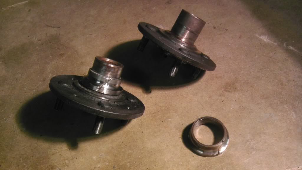

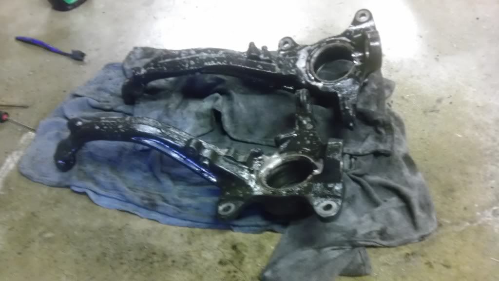

Worked on my front suspension a bit today. I pressed out the hubs, wheel bearings and ball joints and removed the dust covers.
Here they are all naked and soaking in degreaser… I need to order my wheel bearings still
Removed the bearing races from the hubs since they press out with the hubs. I cut them at an angle with a cutoff disc in my dremel. Then I popped the race by hammering a screwdriver in the groove.

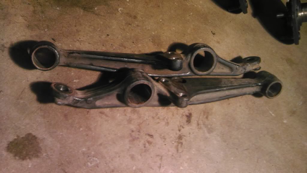

Also pressed out my FLCA bushings
Gotta give everything a good bath/scrub in my parts cleaner and either paint or powdercoat everything so I can put it back together. I also still have to order new wheel studs.
