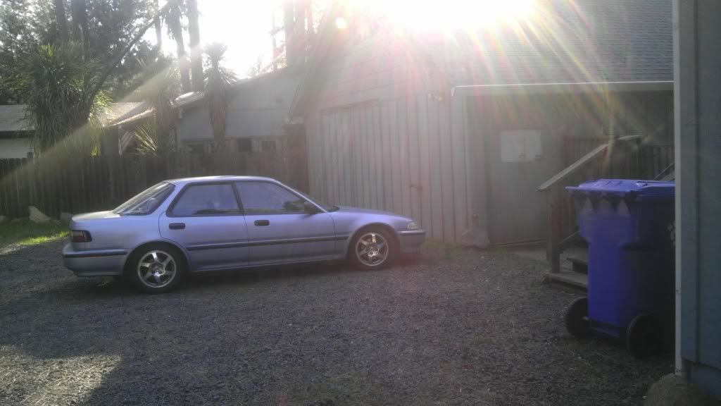

Snapped a pic of my db1 outside my shop. I like the light. Yes its filthy…
Nice DB1! Once my brother gets his set of kosei K1’s I’m going to buy his blades off of him, love the way they look on our DB1’s. And I can’t wait to see those Gales mounted!

Thanks, its not that nice though. There’s one or two angles that it looks decent from though… Haha. I’m going to be doing a full black interior conversion on it soon along with installing all the parts I have stockpiled for it. OEM visors, thin moldings, optional trunk lip, mudflaps, and an OEM cluster to replace the indiglo gauges it came with when I bought it. The Gales will never see this car. They are for my DA. My DA gets all the good stuff…

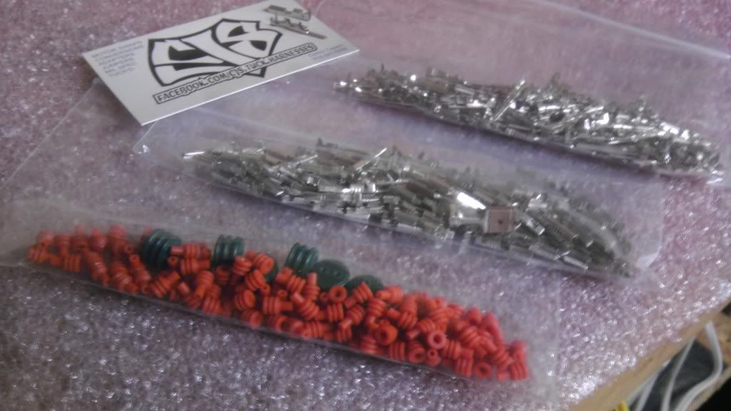

Got my pins and seals today!
I’m gonna have to read through the last couple pages again and see where you ordered those from. Awesome find!
I had found a place last year that had Honda-style pins for like 10c each, but I’ll be damned if my harddrive didn’t take a shit and I lost my bookmark for the site. Not that I plan on a tuck or anything… I just like having those hard-to-find pieces around in case.

I actually never posted it up on my thread. I found this guy Carlos on hondatech that sells miscellaneous pins, seals, plugs, and almost any tucking/wiring stuff you can think of. That’s his card I posted in the picture. Anyone who wants his contact info just let me know and I’ll get you it.
10c a piece is a good price. He charged me 25c a piece but he threw in some stuff for free. It saved me the hassle of digging up the info for each pin and seal I needed and I didn’t have to buy in bulk. I got a bunch of extras just in case and to have on hand for the future though.
That is true man… 10c is great until you have to buy in the thousands lol.
