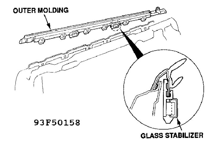

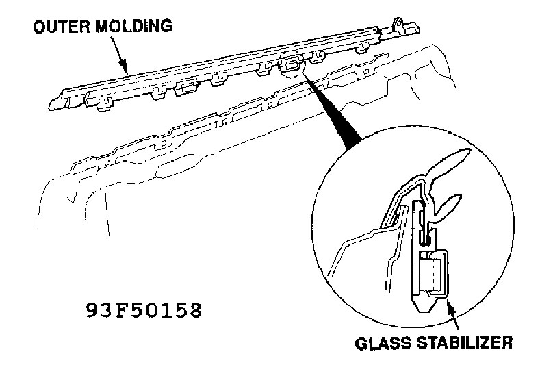

here’s the acura TSB…
FRONT DOOR GLASS SCRATCHES - CONTAMINATED FIBER PADS 91-004
1990 Acura Integra
For Acura Integra
TECHNICAL SERVICE BULLETIN
VERTICAL SCRATCHES ON FRONT DOOR GLASS
Model(s): 1990-91 Acura Integra
Group: Body & Frame
Bulletin No.: 91-004
Date: February 11, 1991
Symptom: Vertical Scratches on Front Door Glass
SYMPTOM
The front door glass is scratched vertically in two places, in line
with the glass stabilizer pads.
PROBABLE CAUSE
The fiber pads on the outer glass stabilizers contaminated with dirt
or other grit.
VEHICLES AFFECTED
1990 Integra 3-door through JH4DA9…LS071062
1990-91 Integra 4-door through JH4DB1 …MS000012
CORRECTIVE ACTION
Replace the scratched door glass and install the new-type outer
glass stabilizers listed under PARTS INFORMATION TABLE.
  1. Remove the door glass.
  2. Replace the original outer glass stabilizers with the new-type
    stabilizers. See Fig. 1.
  3. Install a new door glass and reassemble the door.
