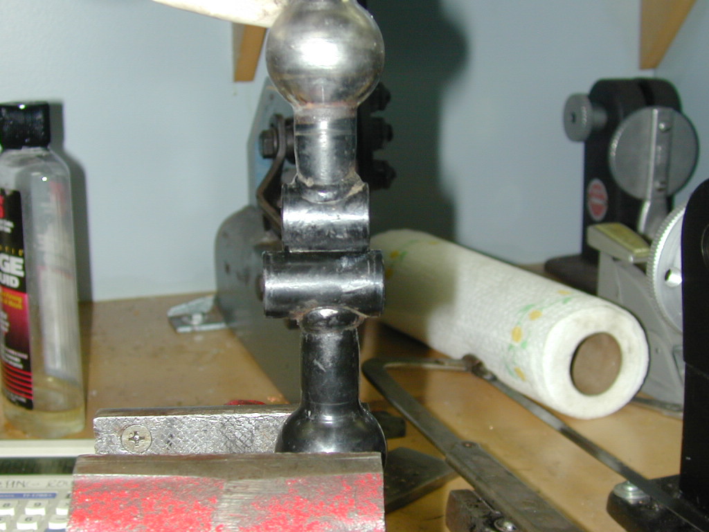

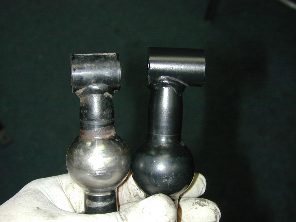

You just need to cut off some material, then it’ll fit just fine. Here are some pics:
Pic 1: DA shifter on the left, modified DC shifter on the right
Pic 2: DA shifter top, DC shifter in the vice ready to be cut
Pic 3: DA shifter, B&M for DA, DC shifter on the right

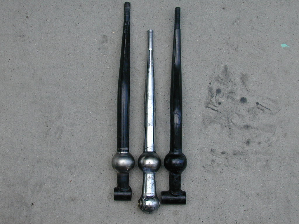

Pic 1: OEM G3 Gsr shifter

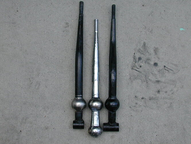

Pic 2: OEM ITR Shifter out of a 98’ DC2
They look pretty different to me. Looks like the ITR shifter has shorter throws.
