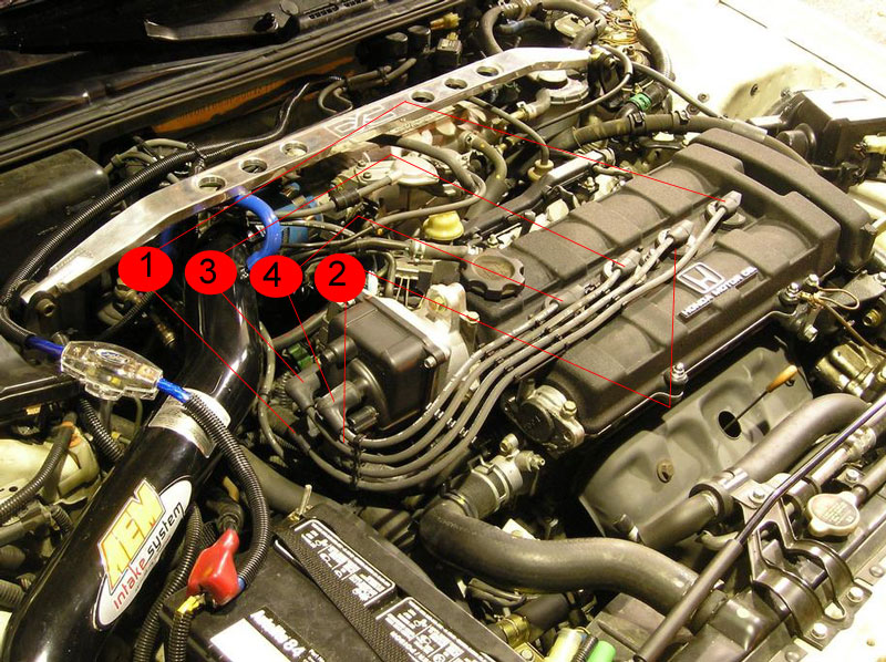

check this out …u guys mean like this right??
i think someone needs to take a picture of an engine, standing over the passenger side fender looking at the distrib like its a clock.
and mark the thing up all clear and everything.
[QUOTE=Malformed;1859984]i think someone needs to take a picture of an engine, standing over the passenger side fender looking at the distrib like its a clock.
and mark the thing up all clear and everything.[/QUOTE]
^^:up:
Well done.
