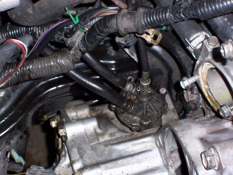

i believe its what the speedo cable mounts to on the tranny. i’m tossing a 17 too since my motor swap in my beater and i’m pretty sure it’s just cuz i have no speedo cable.
it in the top of the transmission housing under the starter. its held in by one 10mm bold and has the speedo cable coming out of the top and 2 PS lines out of the side.

heres a picture of it. the work involved is self explanatory
lol the bolt on mine snapped… didnt have that much force on it i assumed … but long story short the snapped bolt fell into the tranny out of reach lucky me i have an engine that iam almost done rebuilding to go into the car so it all has to be pulled anyways hhah be carfule with it i had bad luck on the easy fix
