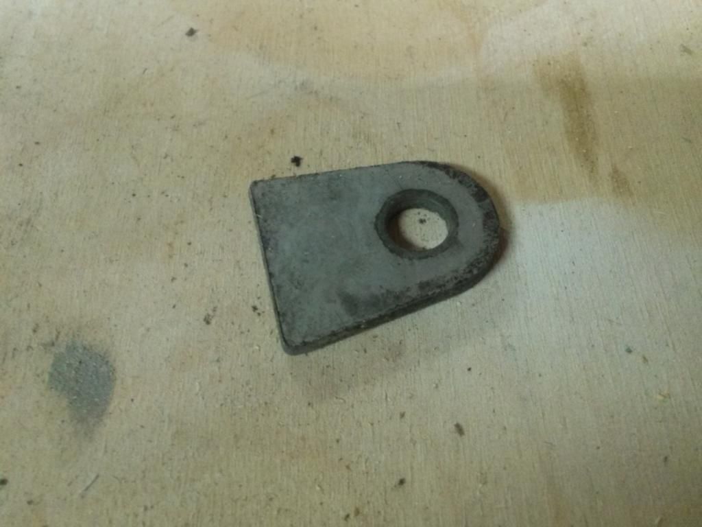

It sounds like you’re missing the bracket for it. Here’s a pic of it.
