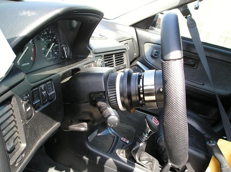

I got a NRG Short hub, The auction said 92-01 Integra so i thought the guy was retarded and didnt know the 92-93’s are the same as 90-91 so i ordered it… And as soon as i open the box there’s a fitment guide… 94-01 Integra.
So i gave it a try.
It wont go down all the way for some reason.
it looks like it sticks out a lot, how’s the placement of the steering wheel? before the short hub, is that another hub? so wouldn’t that be contradicting to the whole meaning of short hub?
