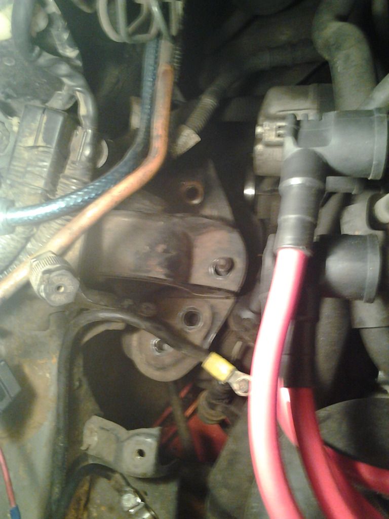

Here is a photo with the transmission mount on the vehicle:

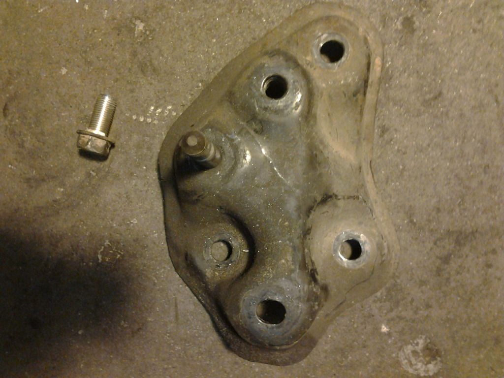

Here is a photo of the actual second plate taken off of the vehicle:

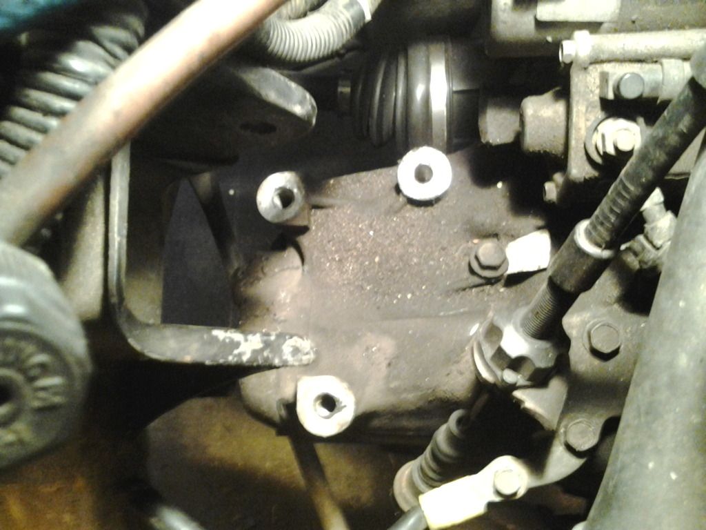

And finally, this is a picture of the transmission when both the transmission mount have been removed and the redundant second plate has been removed.:
Notice how the transmission bolt on pattern is now relative to the actual Innovative Motor Mount bolt on pattern.
