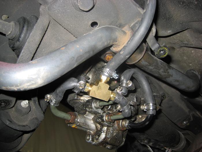

Hey guys I just got done looping my lines last weekend, so far no problems.
As you can see, I just left the two lines going to the speed sensor alone, on the one line from the speed sensor that Ts into one of the return lines, I just got rid of the T and connected the 2 ends together, I then removed the power and return lines (and the whole cooler setup in the bumper), so what’s left is the power and return lines looped together with that filter on it.
There was a puddle under the car for the first few days as excess fluid drained out of the system but everything is fine now. It sits safely against the underside of the car and doesn’t hit the ground or anything.
Turning at low speed is pretty difficult, I haven’t taken apart the valvebody yet. Should I loop the vss at the sensor? Or is having it open like this going to cause problems?

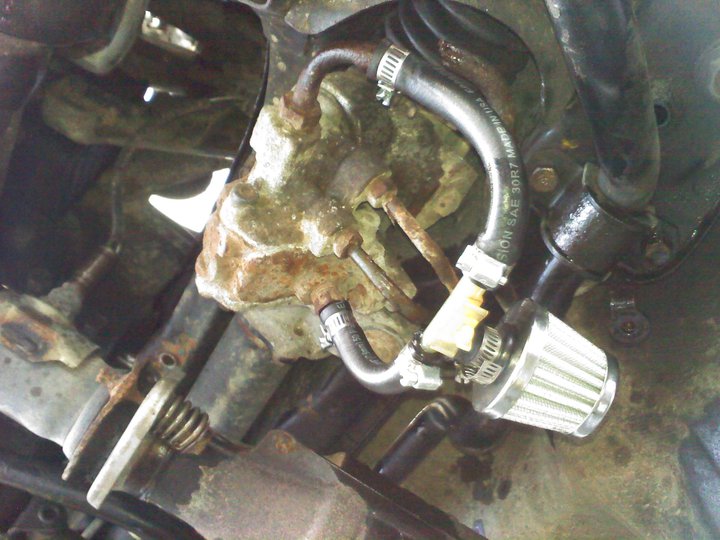

I just looped the lines on the rack to each other, and put a T-fitting for a breather. Not the cleanest solution, but it doesnt leak so, it works for me.

Could somebody tell me the function of this breather on the T fitting? It doesn’t seem to me that the p/s system needs to breath for any reason.

Few questions…I have read this thread over and over again.
I understand how a breather can help purge air/pressure from within the valve body…
So wouldn’t running a longer hose from a t-fitting on the looped lines up to the engine bay prevent any leaking and still do its job? How many of you said F the breather?
Also…once you take the right stuff out of the valve body…I’m assuming all PS fluid gets drained out during this process. How do you re-fill the valve body? Do I just fill the looped hoses and whatever fluid fits…fits? Or do I not even worry about re-filling? I’d like to get all old shitty auto zone PS fluid out and fill whatever I can with OEM Honda PS fluid…
THANKS!
[QUOTE=da6YO;2231409]Few questions…I have read this thread over and over again.
THANKS![/QUOTE]
I’m also curious how many people didn’t bother with the breather, doesn’t seem necessary.
