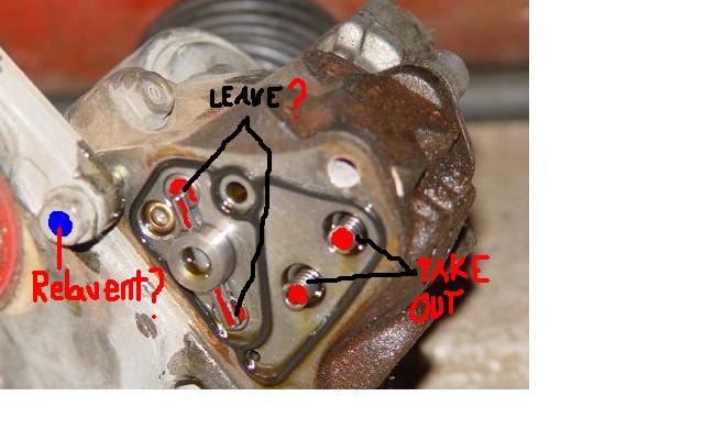

What do you mean to the right? The previous quote said that he removed everything in red. But you said not to remove the plungers/springs with the bar going through them, so why are they in red?. Only the 2 plungers and springs to the lower right of the picture are the ones to be removed? The ones that are spaced out from eachother? Thanks in advance.
Posted up a pic to make it easier. Outlined what I am thinking of taking out and what I think I need to leave so correct me if I am wrong plz and thanks.

^^^ ni you can do it on the car, i just did mines it took about 10 minutes just gotta open the 3 screws on the side and pull out the 2 plumgers with the springs in it, then loop the lines and vss
