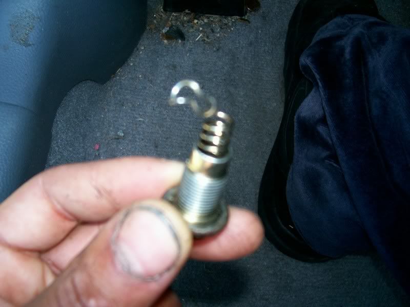

I took my tranny apart and installed my obx diff. Put the tranny back together and it will not go into 1st,3rd,4th and 5th. An old motorsports mechanic told me to check the 12mm screw with the ball and spring closes to the passenger axle. Removed the screw to find that the spring was messed up and the ball was wedged into the screw(sorry bolt). The opening on the bolt is now oblonged(not circle). I replaced the bolt with anouther that my freind had lying around and I have come to the conclusion that when im tightening the bolt its pressing against something inside the tranny. Now im having trouble getting the case off.

pics are blurrd but the 1st pic is the old bolt with spring.

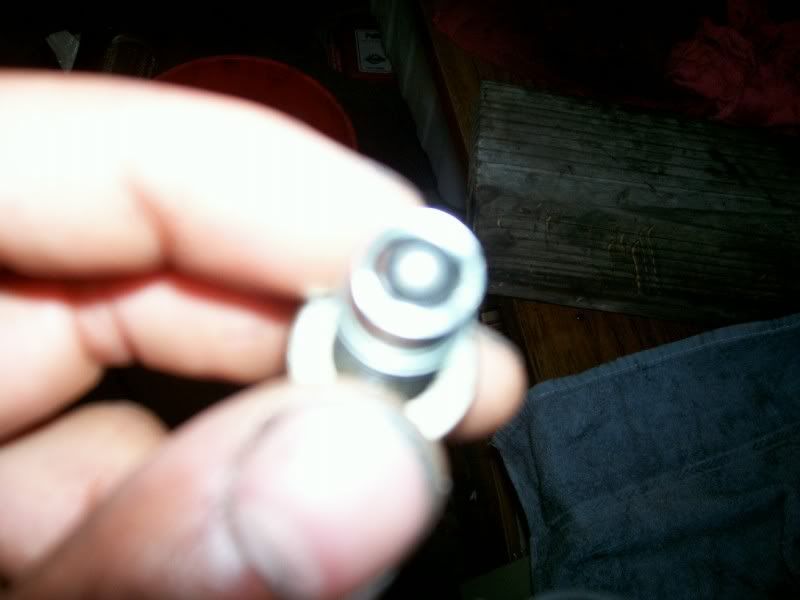

The second one got logged in there and has some marks on the ball. As if it was pressed against something.
