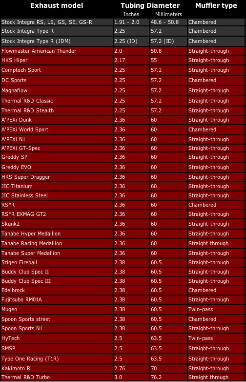

Chambered mufflers are quiet. I only want to spend $350-$400 for a muffler custom installed. I have found a mandrel bend muffler shop in my area.
I only want a quiet muffler. I do not want a muffler that is raspy, droning, loud. The N1 style “straight through” and twin loop mufflers are loud.

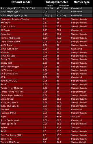

Here is a list of chambered and straight through OEM & Aftermarket mufflers:
