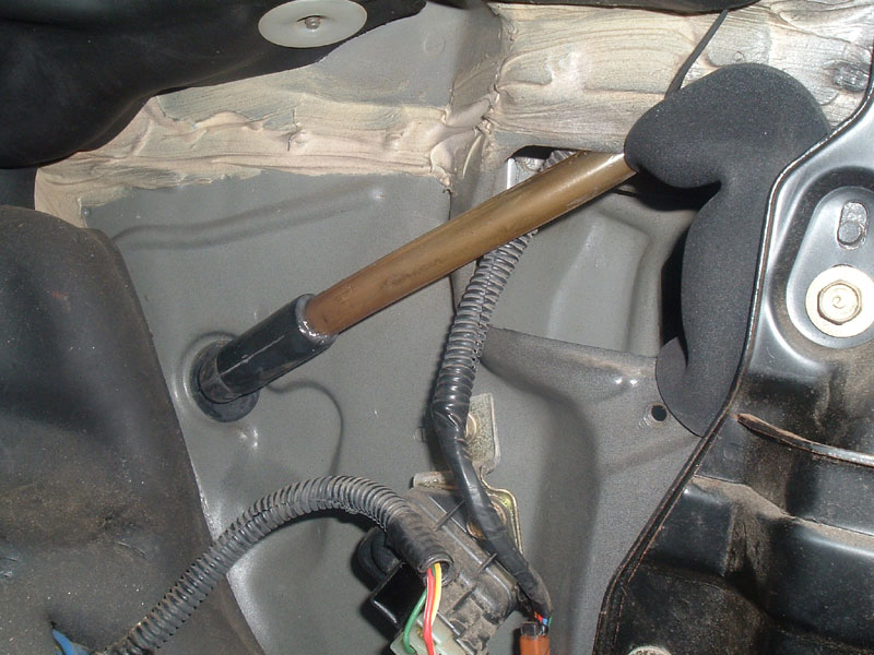

hey guys i decided to do the whole water leak fix cuz like everyone else that has this leak i hate seeing a puddle in my passengers side floor after a hard rain. i replaced the rubber pieces and did all that already. and now im workin on the other 2 leaks. one is my tail light gaskets and the other is this.
Is this hose supposed to be this short??? this is the sunroof drain hose on the passengers side. looks kinda gross. help me out! thanks.

I think the drain hoses shrink over the years, I had 3 out of 4 of my pull out of the lower drain fittings =(
oh my my, looking at the photo again yours is torn, the line should run down the window pillar and out behind the front fender.
thats what i figured =/ i knew it looked a lil short… lmao. im gonna have to get a new hose now…

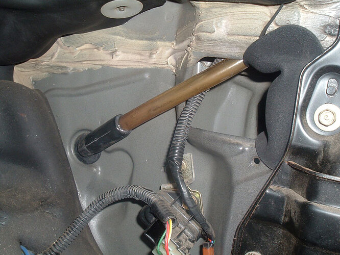

Heres a pictures where that line should drain too, this is where mine pulled out, and you’ll most likely have to remove the dashboard or find someone with tiny hands.

also… i checked to see if my hose exited at the same place as yours and it doesn’t. i have a plug that covers the hole where your hose exits. im not sure where mine exits yet but it stays behind the metal.
problem fixed. went to the junkyard and got the hose and the piece it connects to to drain to the outside :slight_smile:
