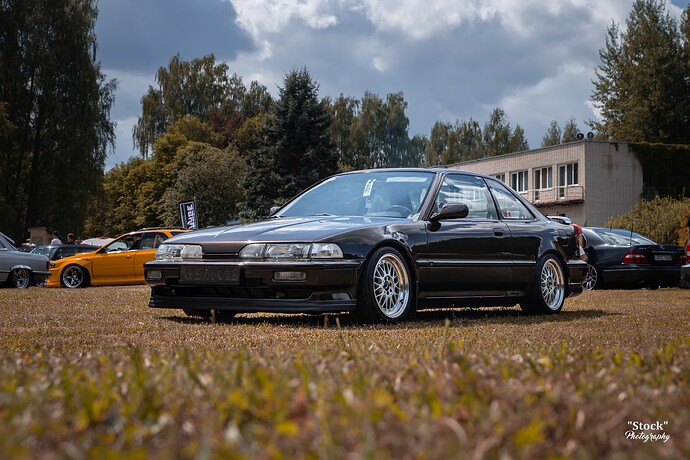

I’m running a Circuit Performance CP23 16x7 Gloss Gun Metal 4x100 [+35mm] no fitment issue .

For 16s, I recommend 205/45.
I run 16x8 +35 with 205/45.
But if you choose those wheels with +20 offset, 195/45 might be a safer choice, because 205s might rub if you are low enough..

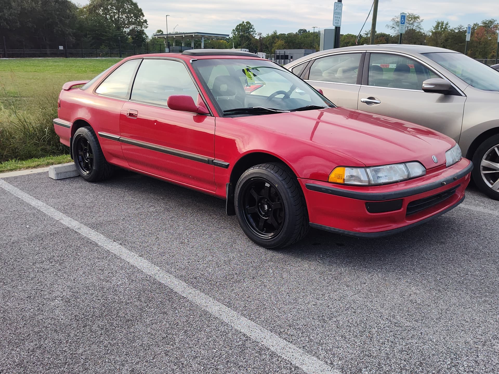

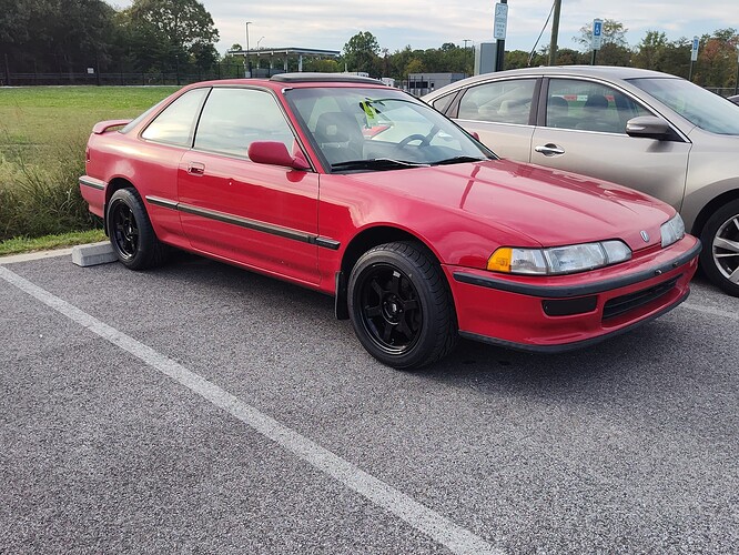

Thank you to everyone who helped or gave me some input. I ended up going with 15x8 MST Time Attack wheels with 205/50 Nitto Neo Gen tires. Going to be lowering her soon.
What were the offset on those?
+35. Still at stock height but it’s doesn’t interfere with any suspension parts even when I turn the steering wheel all the way and it clears the calipers.
I do believe with a 15x8 I should have gone for +28 but it ended up working out anyways
By the way, did you upload that photo with your phone or computer?
I’m pretty sure I was on my phone cause I was just waking up. lol
