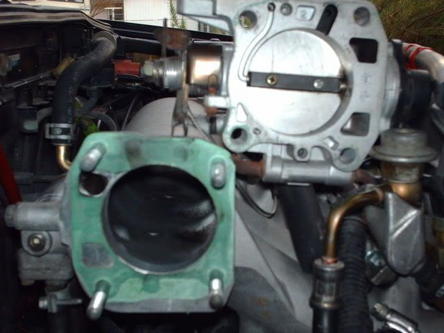

i need a throttle body gasket for my ls-vtec. i have a jg edelbrock throttle body without dashpot and skunk2 intake manifold on a 96 gsr head. should i get a gasket for a 96 gsr? or will any b series throttle body gasket work?
Is the Skunk2 intake manifold made for your GSR head? I’m assuming it is, so a 96 GSR throttle body gasket is what should work. If you can get pictures up of the intake manifold mouth and the I/M side of your throttle body I can help you further.

thanks for the help. i took off the throttle body to clean it up as well as the inside of the intake manifold. now my idle is all crazy, bouncing from 1k to 1.5k. i thought it could be the old gasket so i replaced it, but the problem is still there. ive read the threads about cleaning the iacv, which will be my next move but my idle was perfectly fine before i messed with the tb. any idea as to what caused the iacv to suddenly start acting up?
