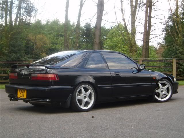

i ran OEM EF shocks and EF lowering springs back when i first got my DA, it was on the floor, although partly due to the springs not being man enough.
if the coilovers can adjust long enough and have a high enough rate you should be fine, but it’s probably somehting you’re gonna have to try and then find out :wink:
car looked pretty sick (even wih the big old 17s) but was only just driveable
excuse for picture >>
