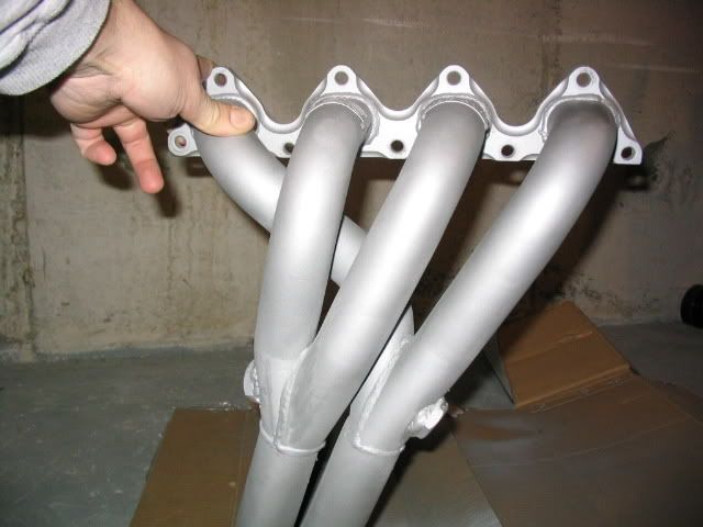

You basically have two options:
  1. get a 2nd bung welded into the header (like this, as you can see each o2 bung monitors the correct cylinders)
  2. get the ecu chipped and have the 2nd o2 disabled (this is what I have done)
