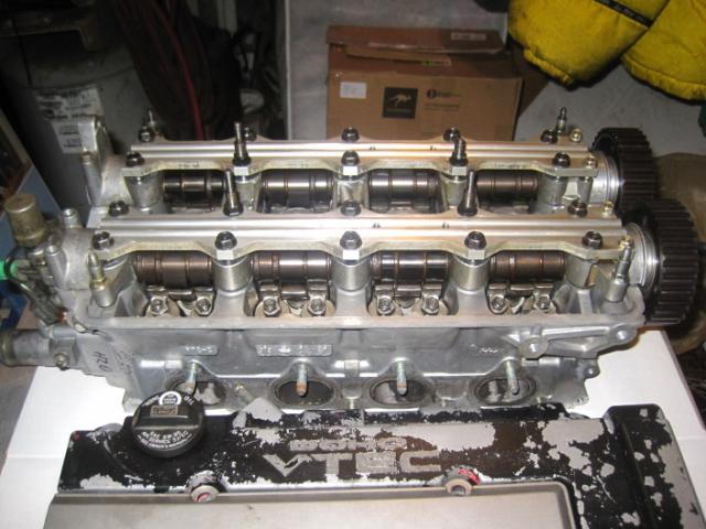

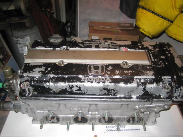

I picked up the GSR head for $250 complete and had my local machine shop perform a pressure test, leakdown test, hot tank it, replace the valve stem seals, and resurface the deck.

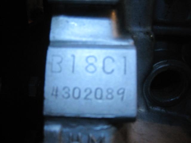

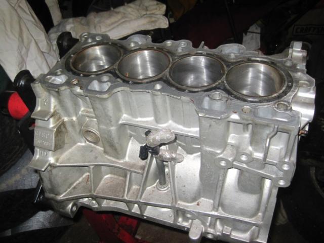

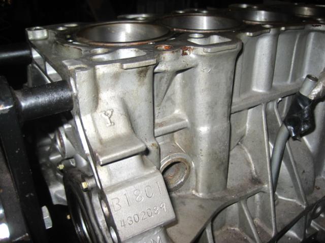

Later on down the road, my brother swapped in a b20 bottom end into his 95 Civic. To make it a b20v and said I could have his B18C1 bottom end.
I think I’m going to build the LS Vtec except I’m going to use the B18C1 block and throw in my LS crank & rods with the pr3 pistons. That way, I will have the benefits of the GSR with the block girdle, oil pump, water pump, and I don’t have to get a Vtec conversion kit since everything lines up and I don’t have to run a vtec oil line. And I still get the torque from the LS’s 89mm stroke.
Sounds like a solid plan?
As a guideline, I used Zeal Autoworks compression calculator. With the b18a1, my C/R would be 12.5.1 which is too high for my taste and the b18c1 with ls crank & rods would be 11.7.1 Much better for daily driving IMO. Does this sound correct?

Yeah, I have been taking a more in depth look at camshafts lately but I think I’m just gonna stick with the GSR bumpsticks. I find it very difficult to find an ideal pair of camshafts. All the cams out there have a super high rpm powerband that suit my needs. I’m only looking to rev at max 8000rpm since the R/S ratio is piss poor at 1.54. My ideal camshaft would be one with the same duration specs as oem GSR, but with significantly higher lift. The closest thing I could find would be Crane Cams #253-0010.
Sticking w/ GSR cams is a waste, you want CTR/ITR at a bare minimum. GSR cams were not made for higher compression, CTR/ITR were and are going to be much better suited to your engine if you’re 11:1 or over. The fact that you aren’t reving above 8k isn’t all that important. So what, you’ll miss out on 500-1000rpm worth of power, but a good set of cams are going to make more power than the GSR cams for the entire powerband.
I’m running 11:1 in my b17a with a CTR intake cam and P61 exhaust cam and generally only rev to about 8k while tracking the car. The engine makes great smooth power and is more than I currently need for track duty.
Cams are an extremely important piece of an all motor car, don’t overlook this item as they can make or break your build. You said that you already have the cam gears and built head, so it would definitely be waste not to upgrade the cams. Based on what you are describing look for used some ctr/itr cams.
You guys are right. What the hell was I thinking?! I know I can run ITR/CTR cams with my oem gsr valvetrain, but is it reliable over time?
I would upgrade the valvetrain as well. The gsr intake valve springs can be moved to the exhaust side as they are the same part # as the type-r exhaust valve springs. Then you just need the intake valve springs.
^Yup. And all the more reason why this should have been considered before having the head worked on.
Fyi the intake valves are different in the type r also but if you’re only revving to 8k the gsr valves should be ok.
