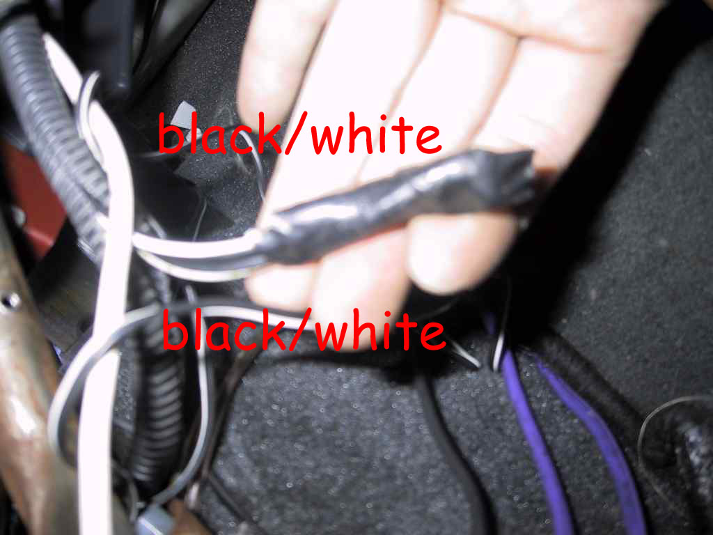

okay, I got all the wiring down for the shifter and what not, but I am a little confused on the wiring for the peddle assembly. I want my cruis to work, can you guys help me out. Can’t wait to get my 89 s1 tranny in! :shift:
Okay, I got it now. So I put the pink wire to the cruise control, and the ‘can’t start the damn car without the clutch pushed in wire’ tothe chassie? Please correct me if this is incorrect.
There are two thick blk/white wires at the 12p connecter in the center console. Those wires get extended to the clutch switch.
