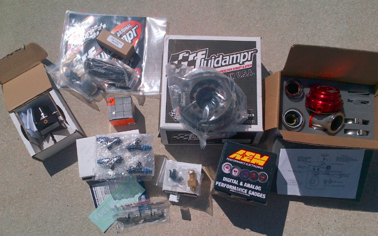

Here you can see just some of what has come in. An Aeromotive Fuel Pressure Regulator, an AEM Billet Fuel filter w/ bracket, Fluidampr, TiAL 44mm Wastegate (love this part, it came with every possible spring), AEM Boost Guage to go with my other AEM guages, now I have all 3, A Mishi thermostat, Oil Pressure Sensor, and last but not least…Fuel Injector Clinic 2150cc injectors. Here’s a pic:

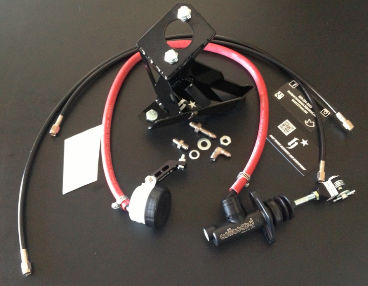

I also decided to go with the Hush Performance kit. Robert Diaz was super cool to work with. That AGP SinCityDAGZR is no joke either. Here is what the kit came with:

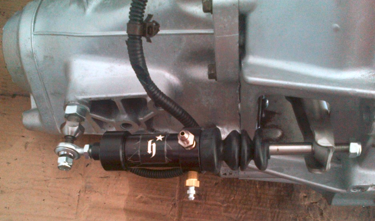

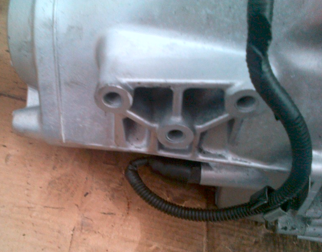

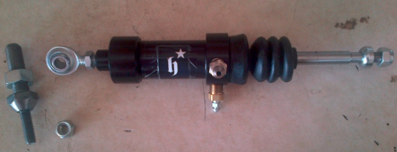

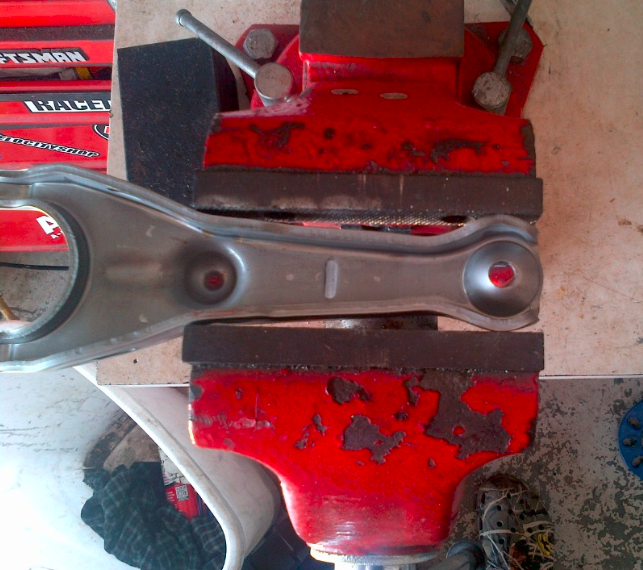

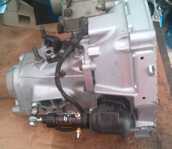

I also bought the pull type slave to help with clearing the turbo manifold. It was pretty easy to install…everything except having to put a hole in the damn clutch fork. MY GOD, what are those things made out of? I blew through 2 cobalt bits just putting the hole in that sucker and that was after i used a grinder to grind it down from behind until a small hole as started!
Here’s the finished product:
After that, I needed to do the worlds most difficult job ever…remove the clutch pedal assy from the car, install the hush bracket and Willwood M/C, all the lines, and then put it all back in. If I never have to remove that assy and then try to put those nuts back on the top left brake booster and the top left pedal assy bracket again,I’ll die a happy man. It was about as much fun as replacing the up pipe on a Suburu. I had some pics of the pedal assy out and with the Hush Bracket installed but I can’t seem to locate them…When I come accross them again, I’ll post 'em up. I almost can’t bear to see them…bad memories.

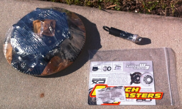

Meantime, I ordered my clutch. I went with a Clutch Masters Twin Disk 745. It was a bit pricey at around $1296 with shipping and after my discount, but I figured this is a big part of my build, why not put good money where I know I’ll need it. Here’s a pic:

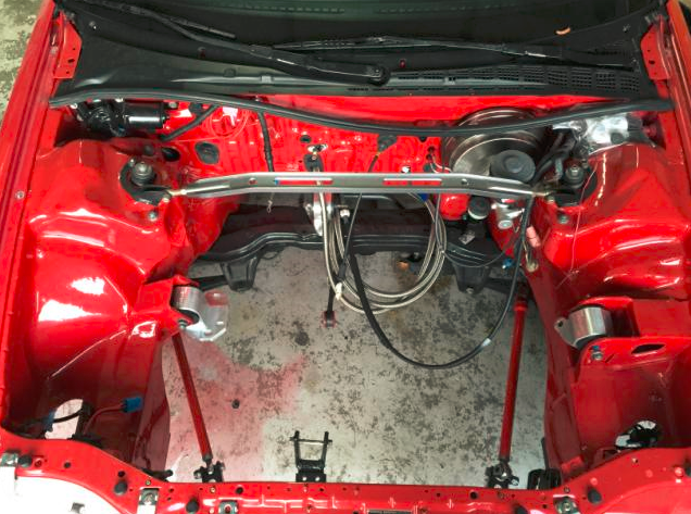

Here’s a shot of the bay as it sits now…within 2 weeks, I’ll have the motor in and that when some real progress will take place.

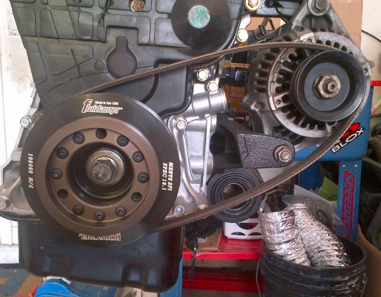

I also installed the Fluidampr

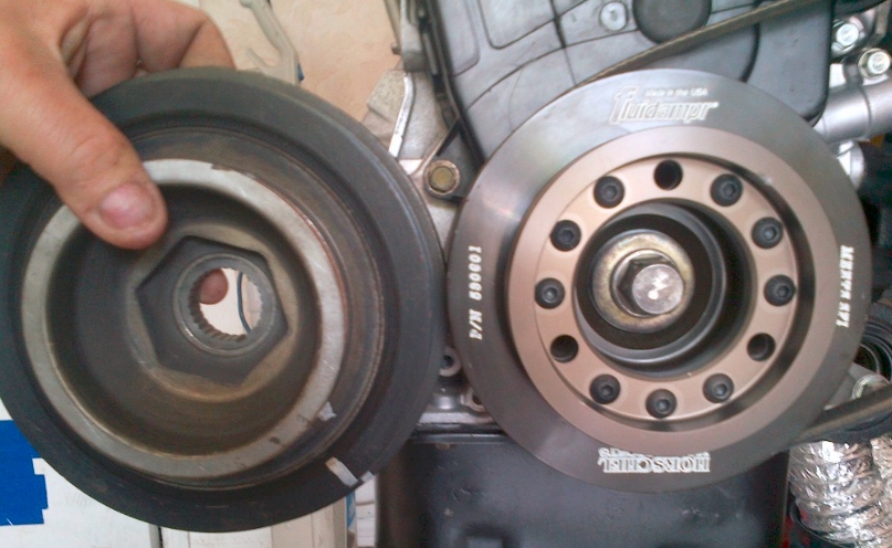

In case anyone was wondering, there is a size difference between the stock b20 crank pulley and the B-Series Street Fluidampr. I ended up having to run to Auto Zone and find a smaller alternator belt:

What belt did you end up using?
