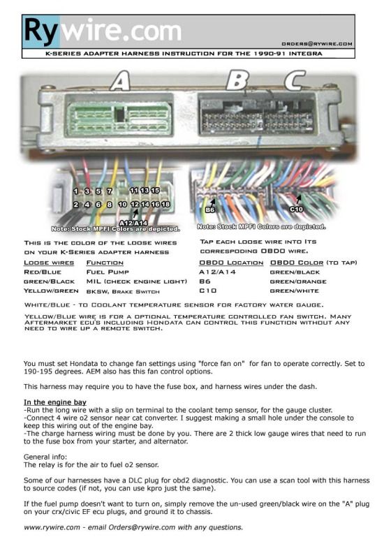

Contacted the guys at rywire for some help with the wiring, turns out i wasn’t suppose to follow the EF instructions…as cool as they were, they revised it that day:
http://i253.photobucket.com/albums/hh61/ricextacy/i_kseries_da.jpg
