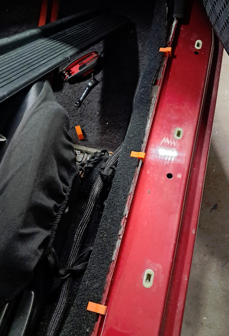

Related to my other thread regarding the aftermarket carpet, I designed these clips with teeth to bite onto the carpet and hold it onto the sheet metal.
Clips are in orange and in PLA material right now in pic. Final ones will be in ABS or nylon.
Comments welcomed.
Update after a few days: These are holding up very well despite being PLA and in the Florida 90+ degree days.
I think installing them every 6 inches / 15cm would be better, along with using the butyl tape to help grap onto the carpet. You can see that I have used grey butyl tape to help secure it to the sheet metal, but it isn’t strong enough alone. (i.e. I used the tape alone BEFORE making these clips.) However, the butyl tape on the underside of the carpet gives the clip’s teeth extra holding strength, and that’s how it’s setup right now.

Amazingly, these things are still holding on, even with PLA. I’m really amazed how well this worked. Will remove and take pix hopefully this weekend.

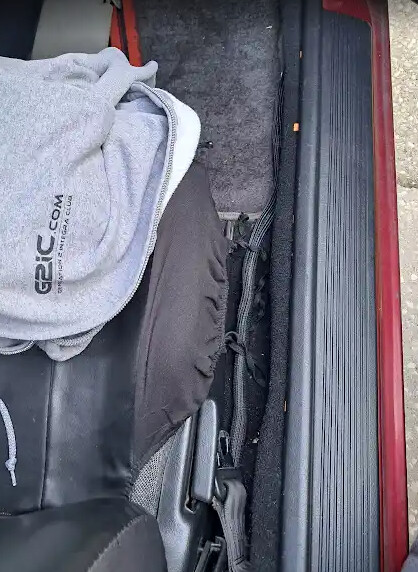

Long pic to show that I may need to shorten these because they stick out from the trim. However, the varied lengths are making me think the sheetmetal isn’t straight. I might keep them long and let the user trim to one’s preferences. They’ll be black anyway.
A few had released their grip, and I think it was because I hadn’t had anyone in the car on that side. I think the jostling of a passenger worked them loose.
No matter though, I know ABS will be stiffer vs the PLA.
