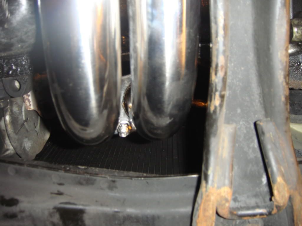

also the header pipe does clear the cross member, but due to the bolt placement, it is very tricky to tighten the last one because there is no room to work with.
http://i173.photobucket.com/albums/w61/dem0logik/DSC01486.jpg
http://www.youtube.com/watch?v=9zJzwP3Oj0Y <- video
For that hard to get bolt use a ratchet with a flex head on it like in the pic and go at it from the top.
