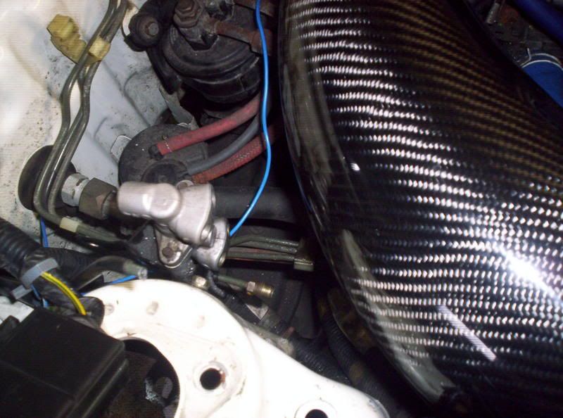

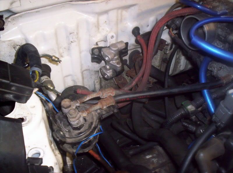

i went back to a later post where i got a respone to this question telling me to put the Prop valve where the fuel fulter is and move the fuel filter to the valve location. the fuel filter has no problem getting over tho the valve location but theres no way the valve will get over to the filter mount, the 2 lines coming out of the fiewall are not near long enough, and i dont now where those lines travel to.

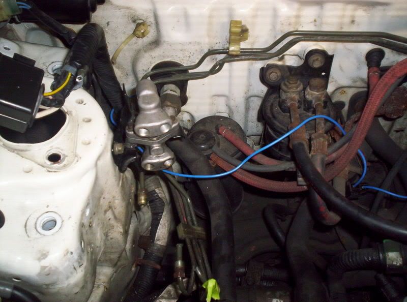

well i did some work today so heres an update, i unbolted the valve and bolted the front mounting hole on the valve to the rear hole on the shock tower. not sure how ill secure the rear hole yet…

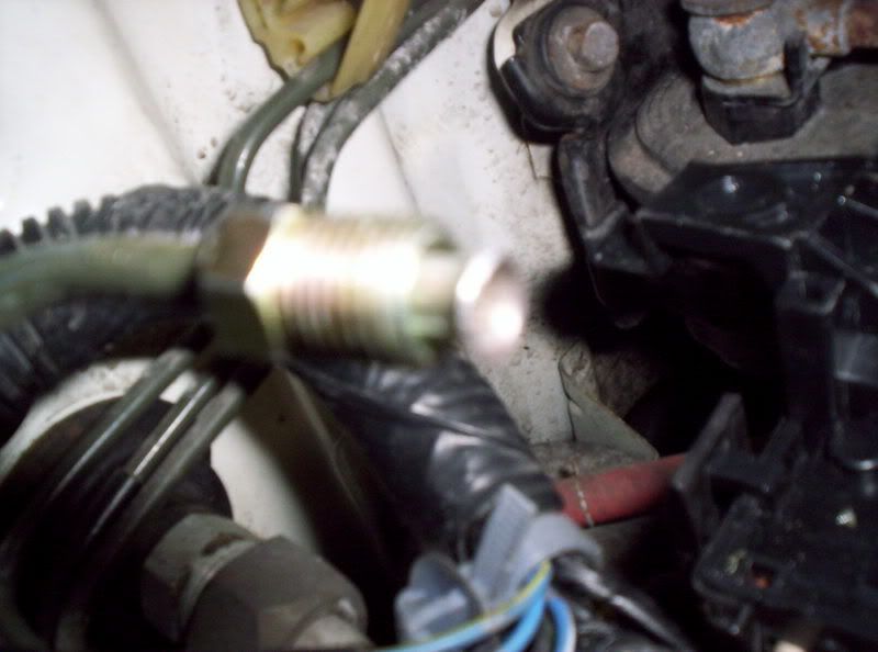

i need to buy new fittings because there were a few that were rusty and wouldnt budge so i ended up destroying them trying to get them out. and it seems that the flaring tool i got isnt working on the tubing. what flaring tool do you guys use?

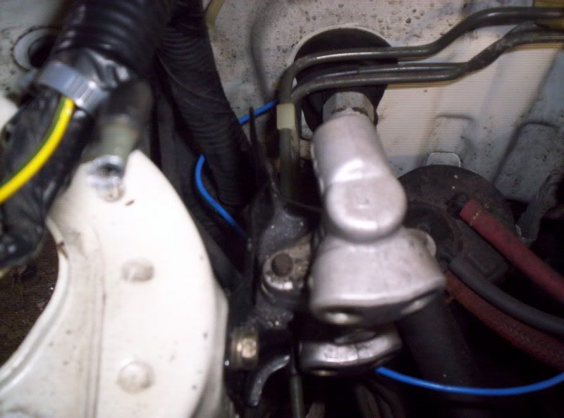

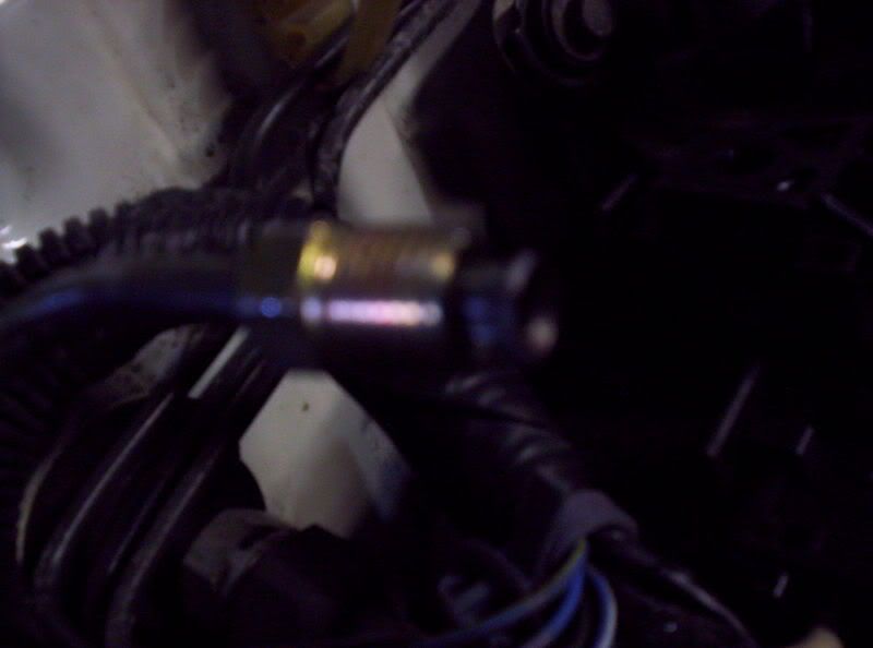

i know the pics are a little blurry, but this iswhat i came up with today.
the flare nut fittings Advance Auto sold me were “standard size” for 3/16" line. they were slightly shorter then the stock ones but with he amount of excess thread that stuck out on the stock ones, i figure these will work. they tighten all the way, with just barely room to spare.
BTW i went through the process of double flaring the lines, whether or not it resulted in double flares or not i dont know. cant really tell.

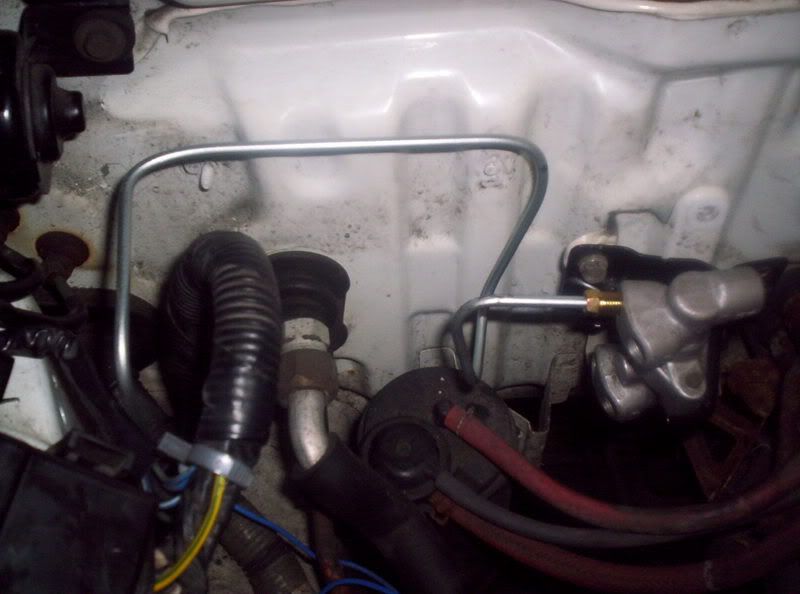

and put the prop valve in the fuel filters location, and moved the fuel filter to the prop valve locaton. the FF gives more than enough room for the intake.
so far ive bent and installed the front wheel lines without much trouble. i tried not to make any bends that were more extreme than the stock bends. mostly 90 degree bends and lower. im also gonna put a bit of thread tape on the fittings, so if i have to remove them later, theyll be less likely to seize.

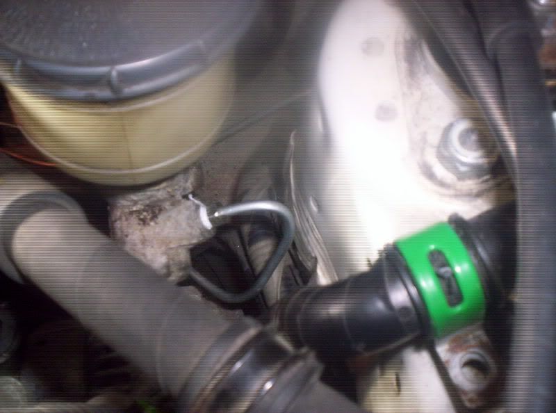

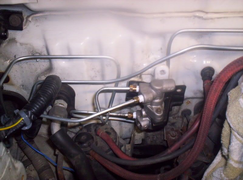

here are a few pics so far. :J:at least let me know what YOU think, since noone else wants to help.

one more line installed…
this bend was a BITCH…
congratulations on doing this with almost no help, i would have been able to help you more if i had actually seen the thread sooner, looks likt it came along nicely. now you just gotta clean out the rest of your engine bay.
WOW,
That looks awesome man, congrats. I don’t see any problem with what you are trying to do or how you’re doing it. I think that if the lines are slightly longer, its the least of your problems. I would just be careful that when you bleed the lines that they are firm and without bubbles. I believe that Honda installs the P-valve at a height equal to or just slightly “higher” then the MC for air transfer or any error they make with bleeding the brakes at the factory.
