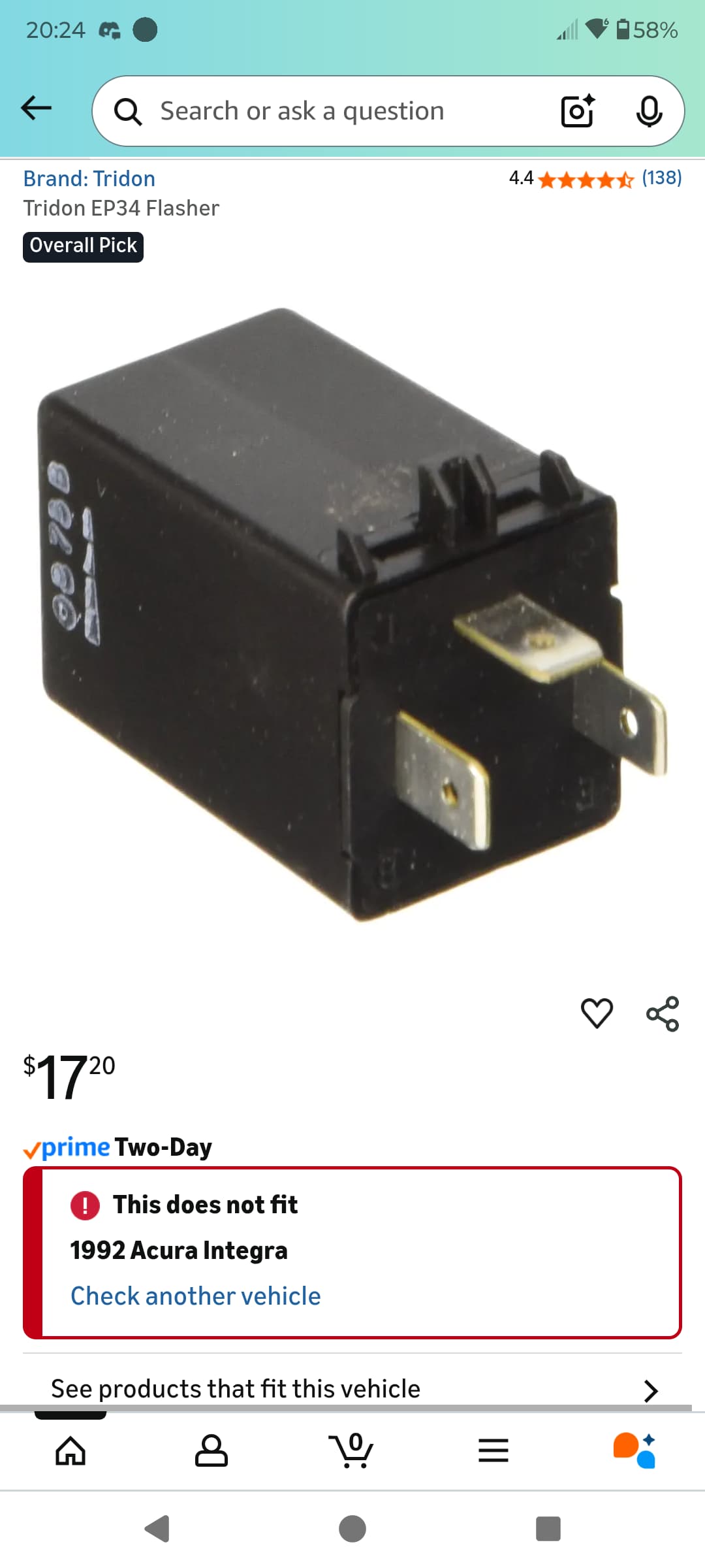

You can see the flash rate here. I will try to get that relay ASAP.
Flasher relay: Tridon EP34
Thank you homie. Going to see where I can find it.
Is this what it looked like by chance?
It did. Now that’s odd that’s it’s saying it doesn’t fit. Crap, did they change the dimensions?!?That’s the issue I had with another one that supposedly fit: there was a notch that caused it to not seat properly.
Let me remove it to see whether there’s any identifying numbers. I’ll take some dimensions too in case they listed some there on Amazon.

Random: did you ever get this?
Yes I did. Thank you for checking in. I’m still testing out some relays. On my 91 DA I had previously, I just changed out the relay for an LED one and it fixed it. So I’m starting to wonder if it’s the plug the relay goes into. That’s not likely though cause with the relays I’ve tried so far, my 92 doesn’t even start up without the OEM one. So I might just go the resistor route.
Did it at least fit properly into the socket? (The Tridon one)
All of them have.
Okay great! I had some that did not fit but apparently it’s really hit or miss because the dimensional tolerances aren’t all that consistent.
Maybe that’s why they aren’t working. Must have got lucky on my 91 for that relay to be set up correctly
