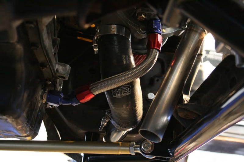

  3. The tube that runs off of the wastegate is a called a Dump Tube. Some people run them back into the exhaust system and some don’t. I didn’t. It justs comes out behind the traction bar.
Here is a pic of where the Dump tube goes.

Im sure you know this but, with ur dump tube right there you could be sucking up exhaust gases back into the turbo and robbing power. if you extend the pipe down to right at the oil pan and pointing backwards toward the rear of the car you have no way of sucking these gaes back up n wont be losing any power…
just a lil fyi.
