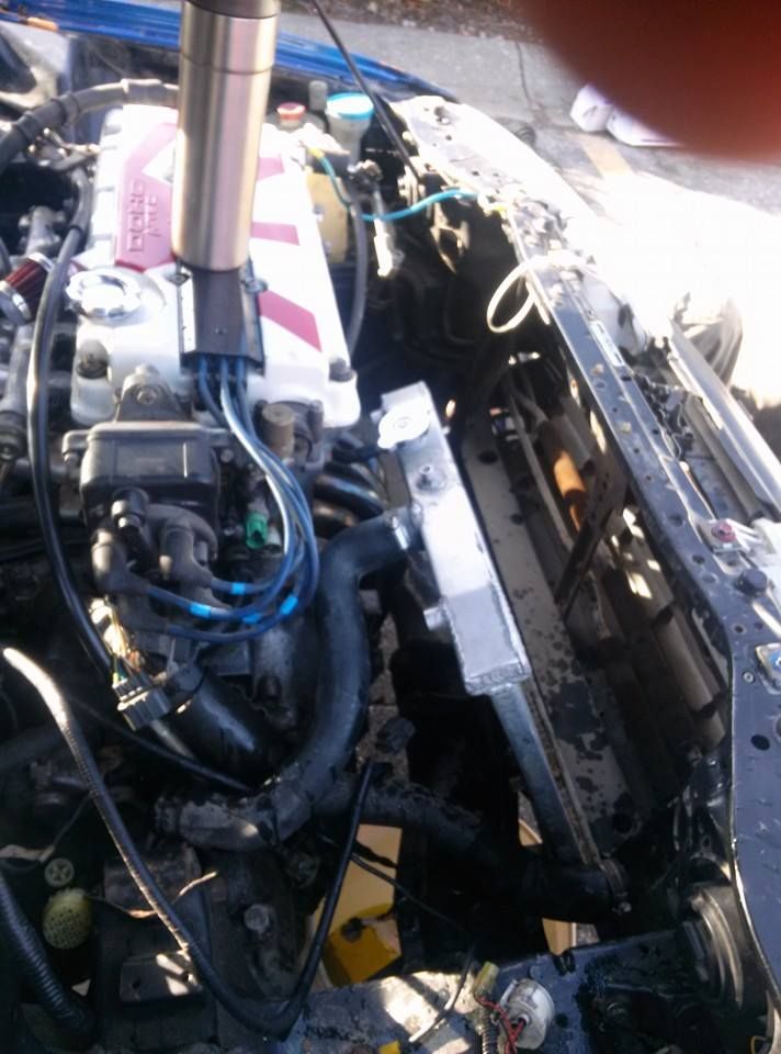

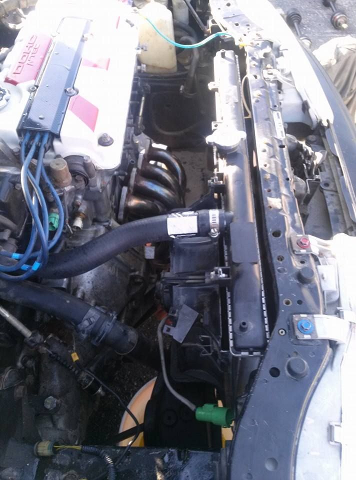

1 in process of draining radiator and removing it, i also removed the not needed ac condenser
2 radiator removed

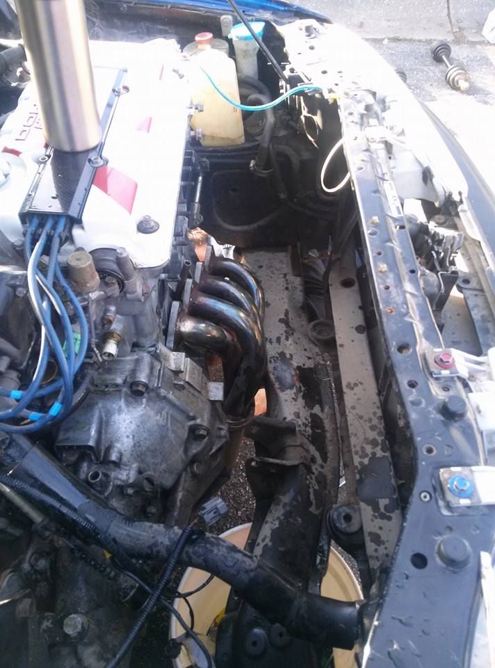

3 Full size radiator installed

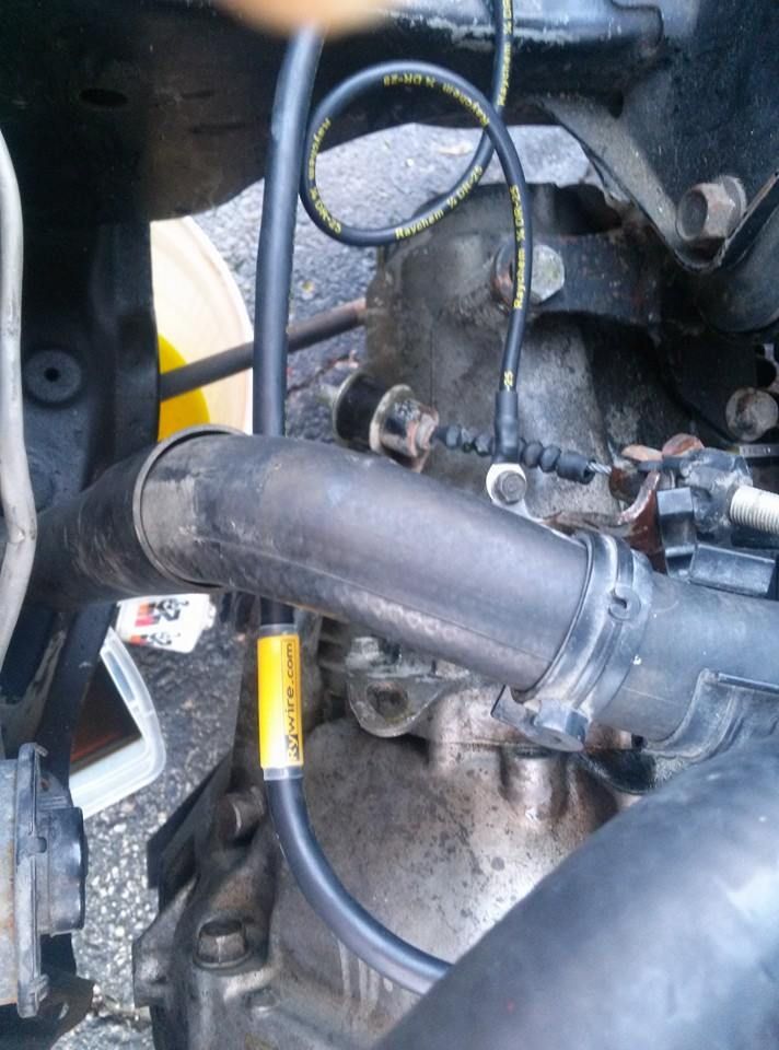

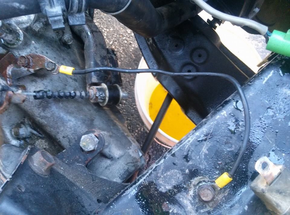

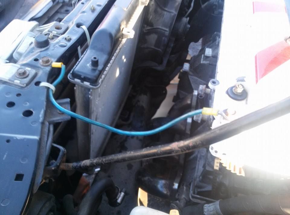

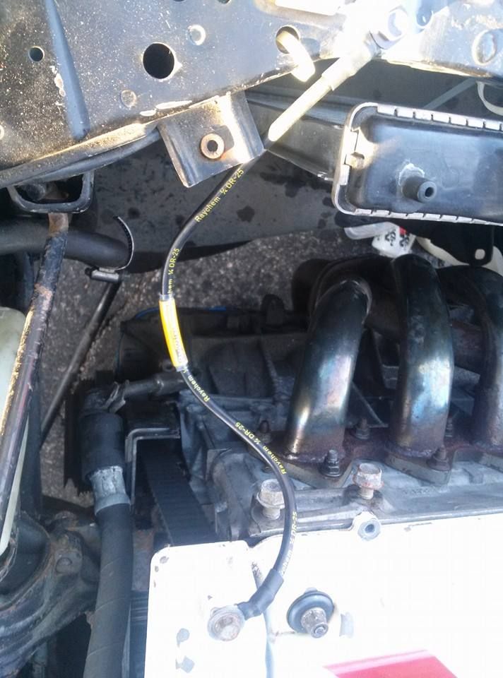

the next pics are of the previous owners ideas of good grounds, in my opinion not so great. Replaced with RyWire ground cable kit
4
5
REPAIRED
6
7
REPAIRED

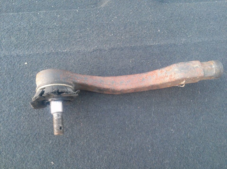

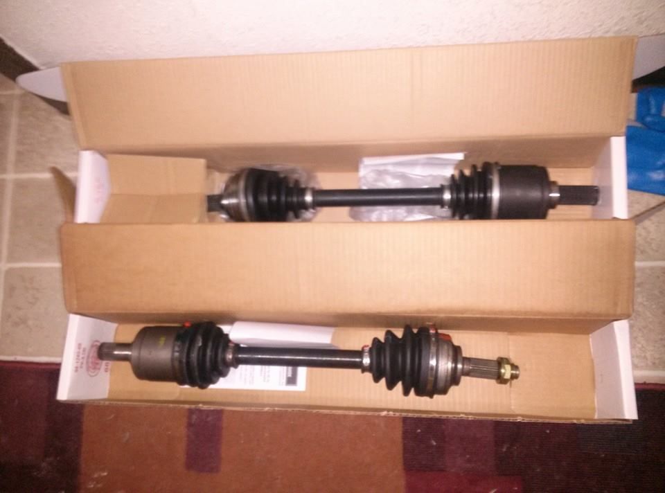

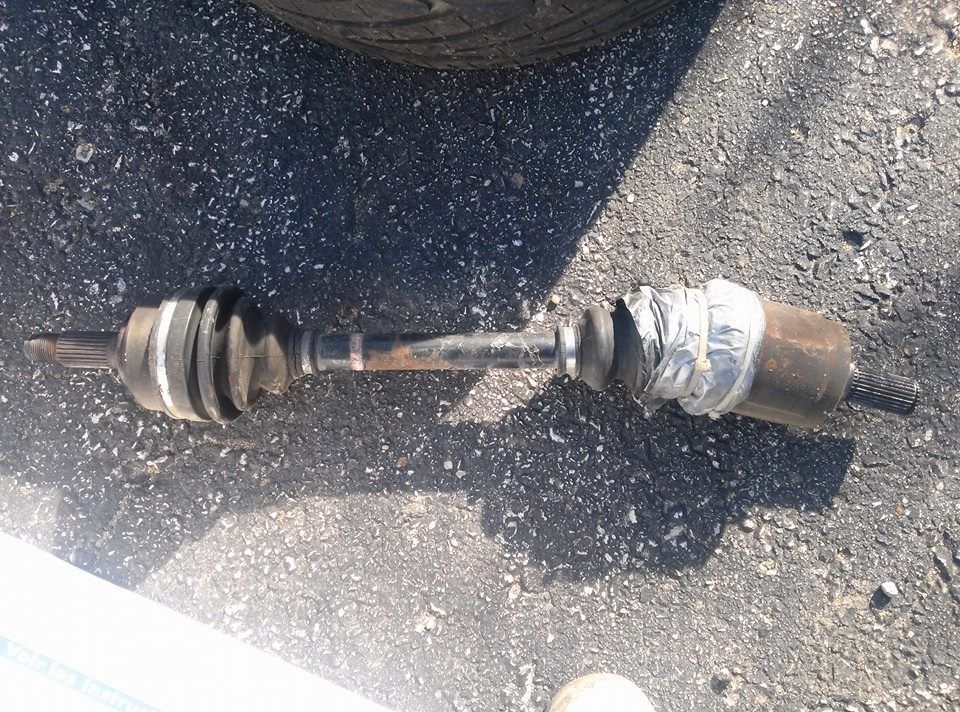

This is the drivers side drive shaft that was in the car upon purchase
8
SOLUTION NEW driveshafts

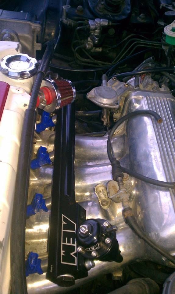

New parts on fuel rail. RDX injectors, AEM Fuel Rail, AEM FPR.

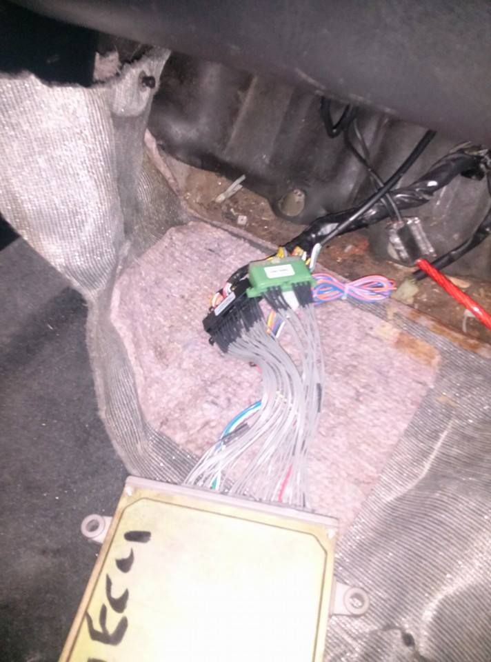

Remember the YELLOW ECU hacked jumper harness
Heres my answer to solving that problem RYWIRE ECU Jumper harness with VTEC sub-harness

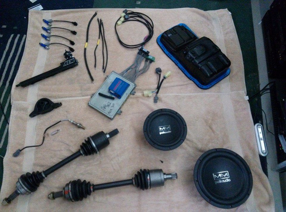

AND last for this reply all or most all the parts that made this progress possible
12

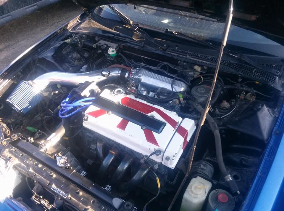

Update as of today.

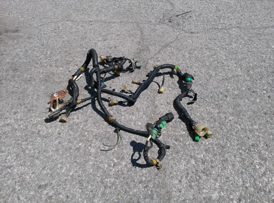

I just finished modifying the engine harness. I had to delete the resistor box since i upgraded to the SATURATED Acura RDX 410cc injectors.
I also figured out where all of my plugs on the wiring harness go back to. When i pulled the harness i forgot label them. so now all i need is some sunshine and a decently warm (above freezing lol) day, or just a warm hour or so. to install the harness.

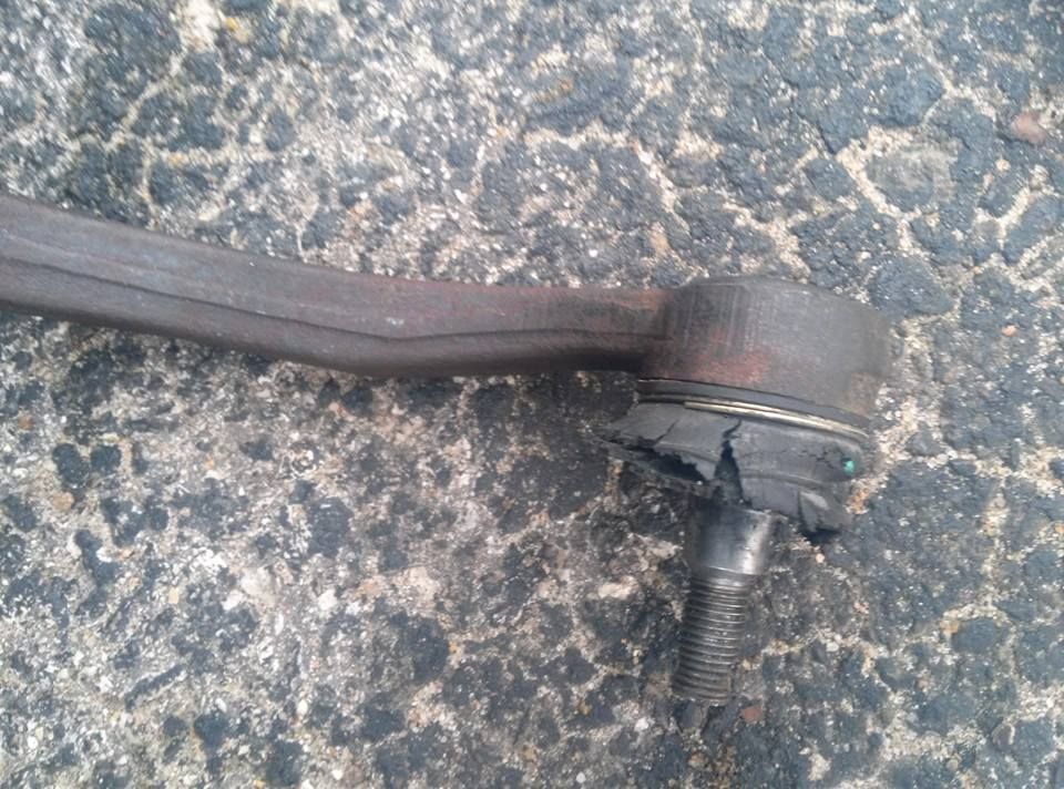

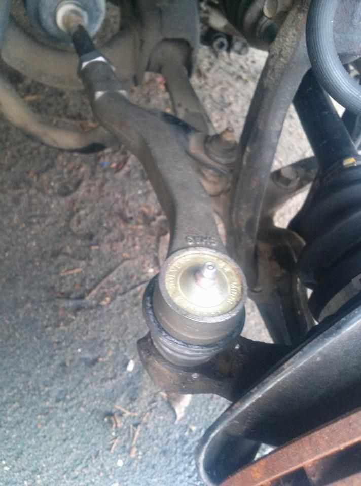

Also found out im going to need ball joint boots and tie rod end boots. Which i think im just going to replace all of them. Therefore i know its been done and dont have to worry about it.

That axle "repair’ blows my mind
:bang: on the axle that was on the car…lol
i know right, that is just plain WOW. nothing surprises me on this car, ive come to that conclusion
Good luck with the project. Fixing an older car is a lot of work even without cleaning up someone’s mess. That axle is pure win. :slight_smile:

well started installing the wiring harness today. got the fuel injectors, the ATS, the coolant temp sender and sensor, both sets of main plugs hooked up, the MAP, the TPS, the distributor, VTEC, starter and alternator the green plug and single pin plug on the back of the block.

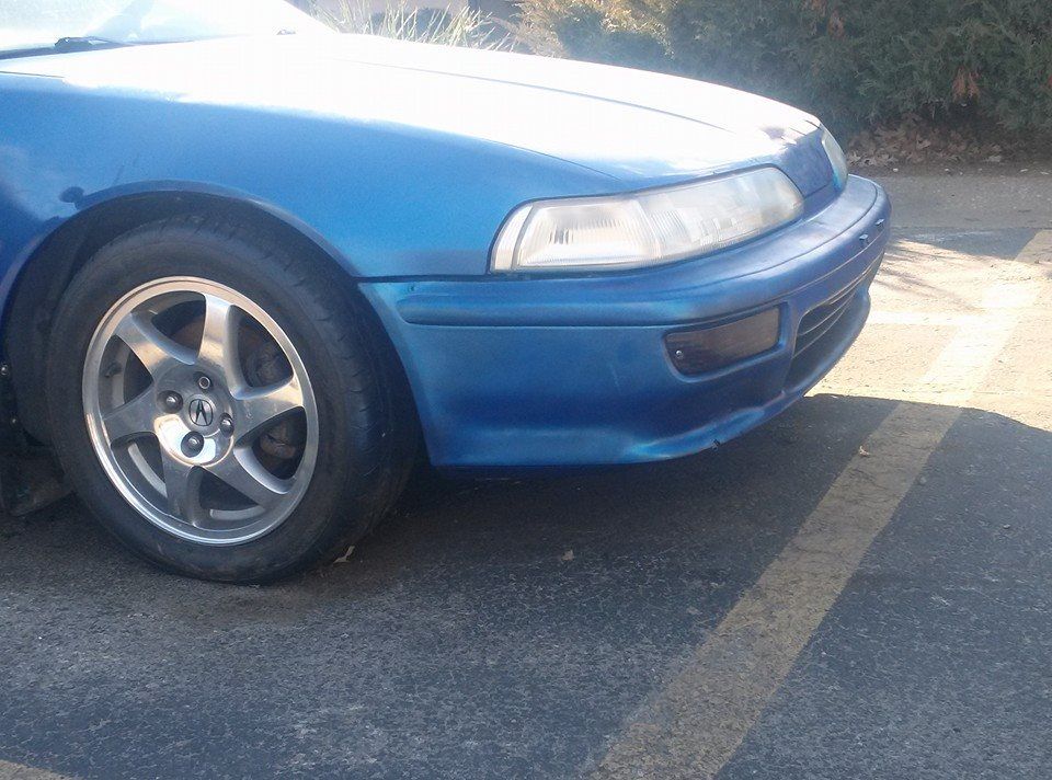

did a quick spray paint job on the front bumper today as well. it aint a master piece but at a distance it matches the rest of the car now. I will be taking it down to the plastic again and doing a total respray of it. or getting a 90-91 bumper for it as I like the look of the 90-91 bumper better with the one-piece headlights.
will take a pic tomorrow of the quick painted bumper. hopefully post it tomorrow too.

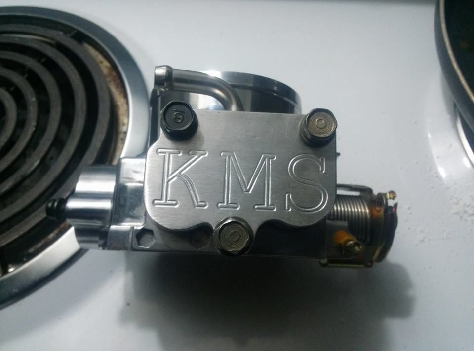

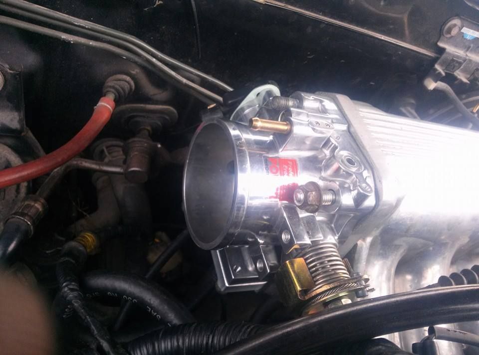

got my Professional Products 65mm Throttle Body in the mail Thursday. i stupidly ordered the wrong one. i needed a b16a and i bought a b18c i was thinking along the lines of how they usually group the b16 and b18 together with a lot of gaskets and intakes and i didnt know they made a b16a TB.
Sooo. the main difference i found is that the IACV for the 94-01 is on the bottom of the stock TB (which is where its setup to be installed on the aftermarket one i bought.
I guess im gonna go source a 94-01 IACV and just re-route the coolant hoses to where i need them to be and remove the one on the back of the intake. Correct?

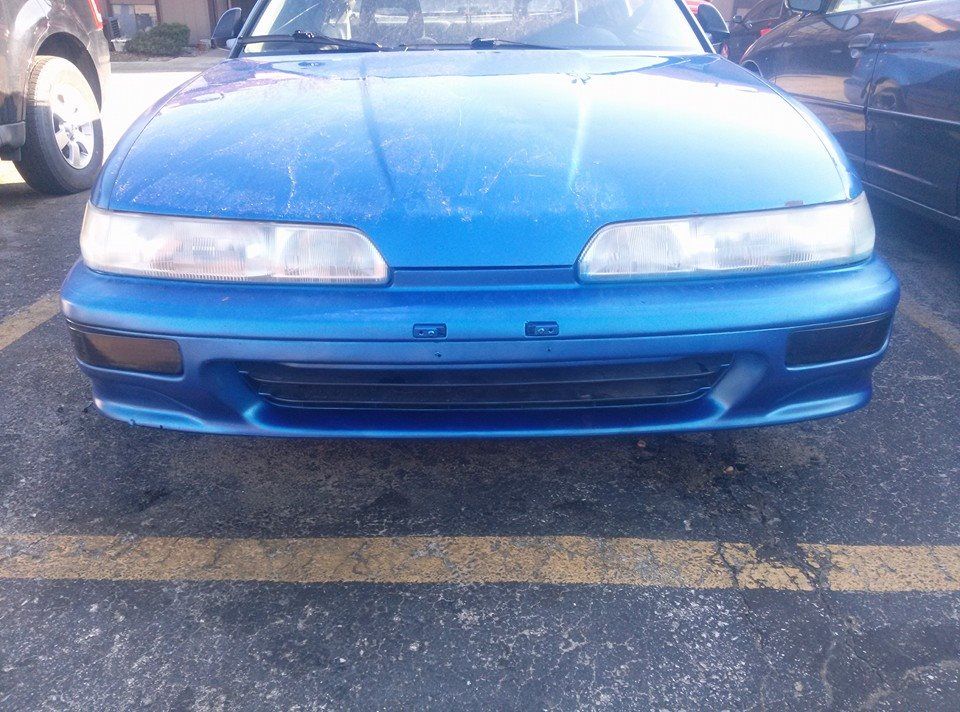

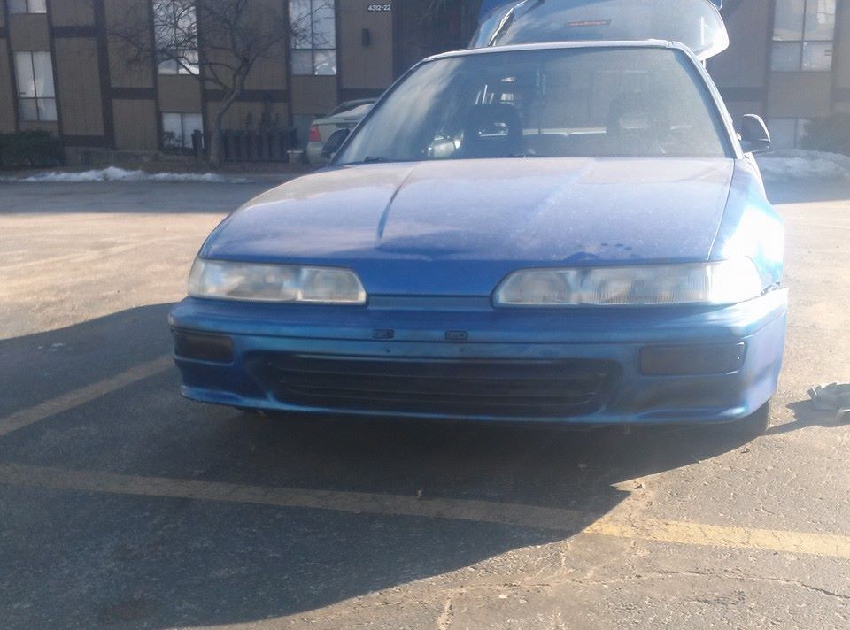

here are pis of the quick paint job i gave the bumper
BEFORE
AFTER

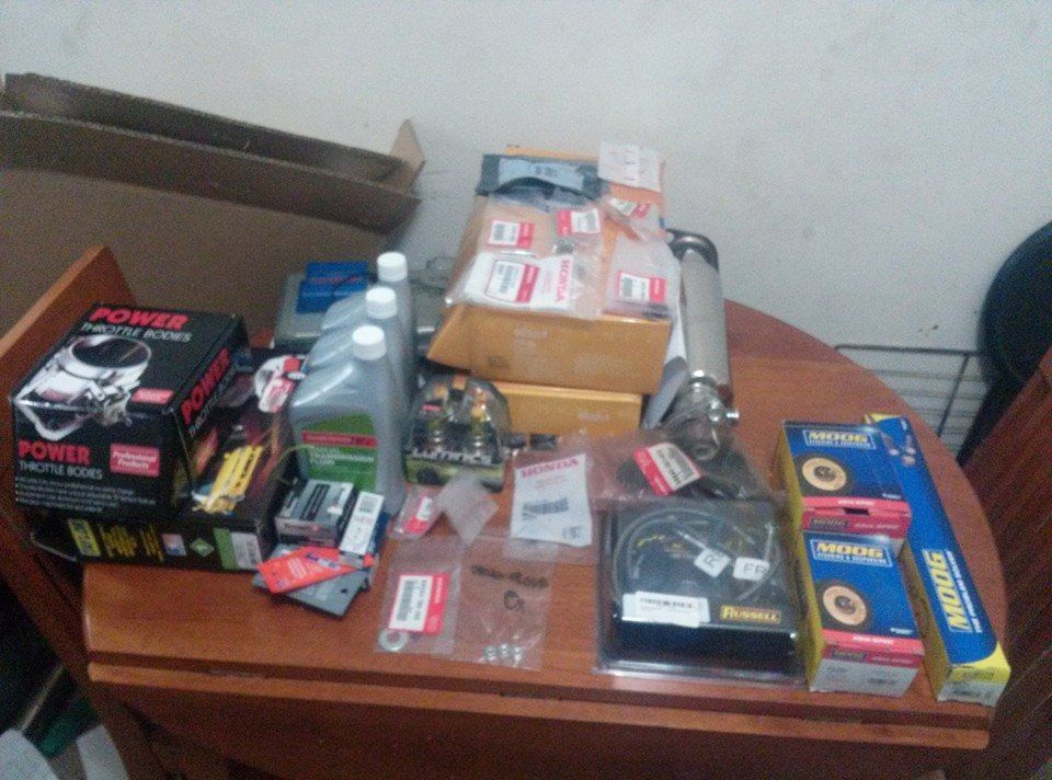

heres some more pics of what ive bought and what ive got done

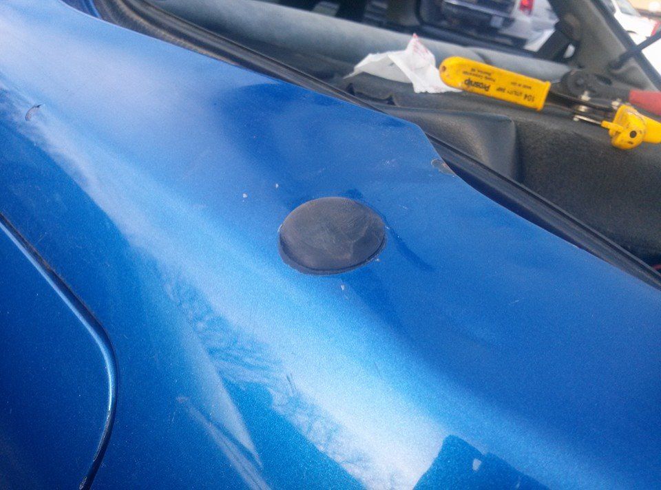

Antenna delete
Installed new Professional products 65mm throttle body with FITV block off plate.
Filled transmission with Honda MTF
Installed Luminics Japanese Yellow H4H headlamp bulbs
replaced both outer tie rods.
reinstalled factory radio harness
installed my Infinity Reference series 6.5 inch coaxials speakers.
Final stage of Vacuum delete all that remains is the FPR and the MAP sensor

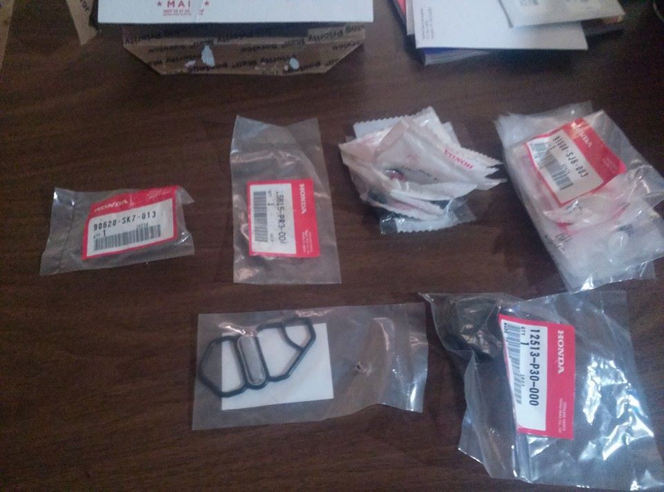

Installed new injector cushion rings
Installed my NGK heat range 7 spark plugs

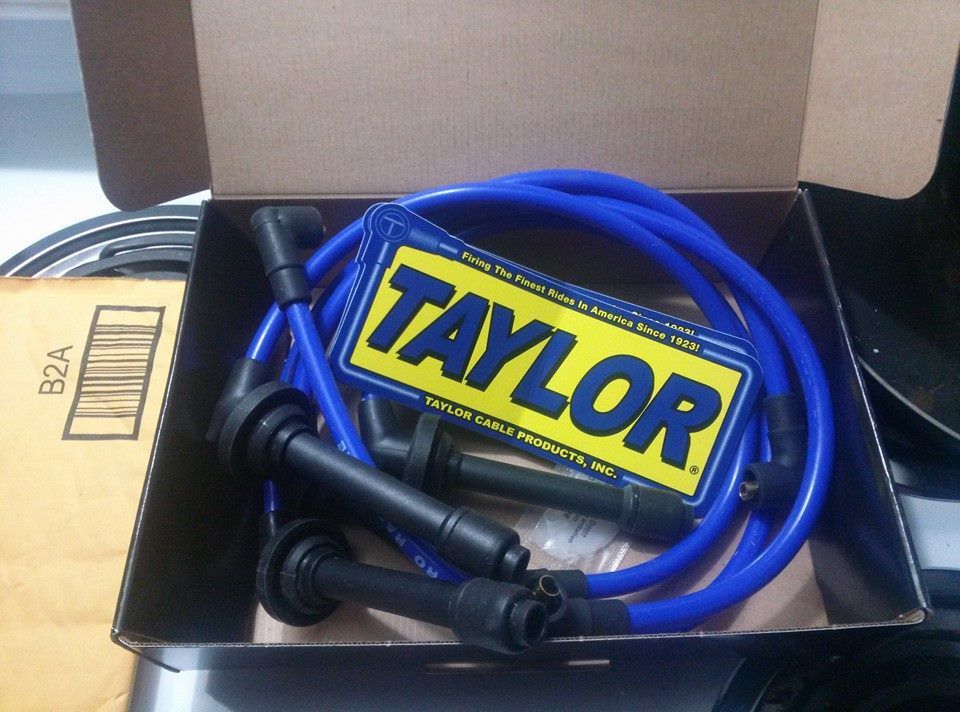

and installed my Taylor 10.4mm sparkplug wires
installed new VTEC gasket
INstalled my reverse light backup switch into the transmission

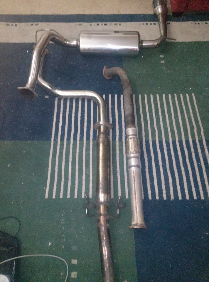

bought a cat back Tsudo exhaust

thanks! The throttle body i bought on Ebay. its technically for a 94-01 GSR. i wasnt paying attention when i bought it. Its a Professional Products Throttle Body. 65mm. (same size as an ITR) part #69600. I found it for 90 bucks. which was half price.
