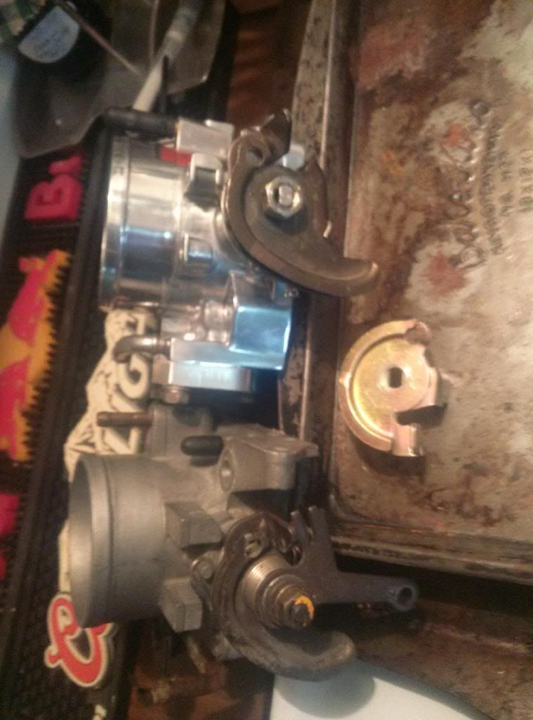

[QUOTE=jtkc;2313425]thanks! The throttle body i bought on Ebay. its technically for a 94-01 GSR. i wasnt paying attention when i bought it. Its a Professional Products Throttle Body. 65mm. (same size as an ITR) part #69600. I found it for 90 bucks. which was half price.
Bought my RDX injectors from RyWire.com the only thing i found out with OEM injectors is. i dont think you can go over 10psi above stock fuel pressure with them. but they are plenty if i stay pump gas. will barely let me skim by if i go E85[/QUOTE]
Hat a direct bolt on or requires some modifications to make it work. I was ranking of upgrading to MDX injecor, I hear it has a better spray pattern but cant confirm that.
well, the only thing i had to modify was the throttle cable mount. and adjust the nuts on the throttle cable. i also had to dremel grind the throttle cable rotor on the throttlebody. Yes the RDX injectors have a very good spray pattern, supposedly best one out there.

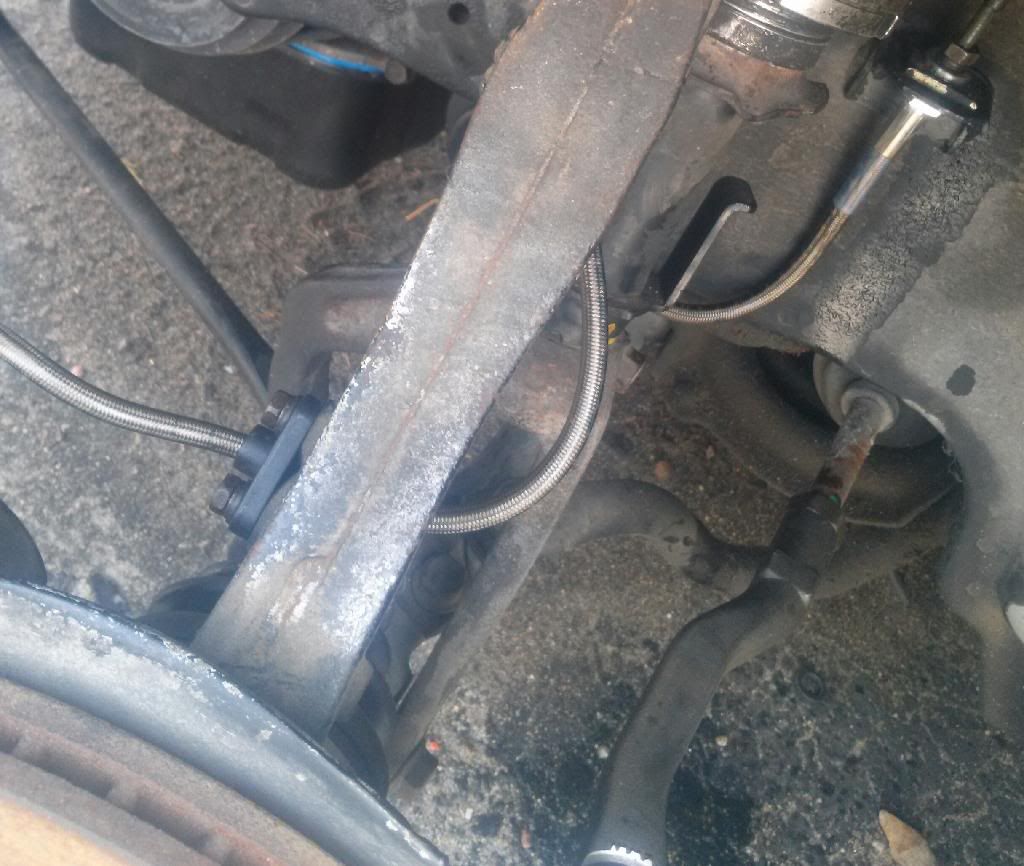

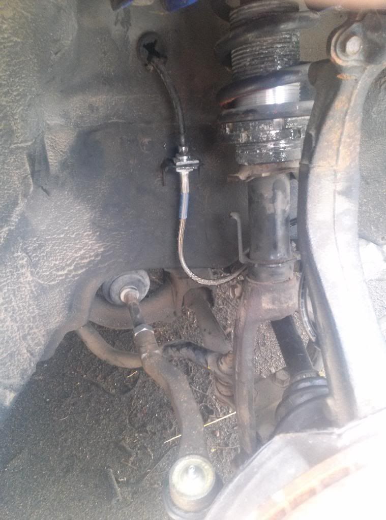

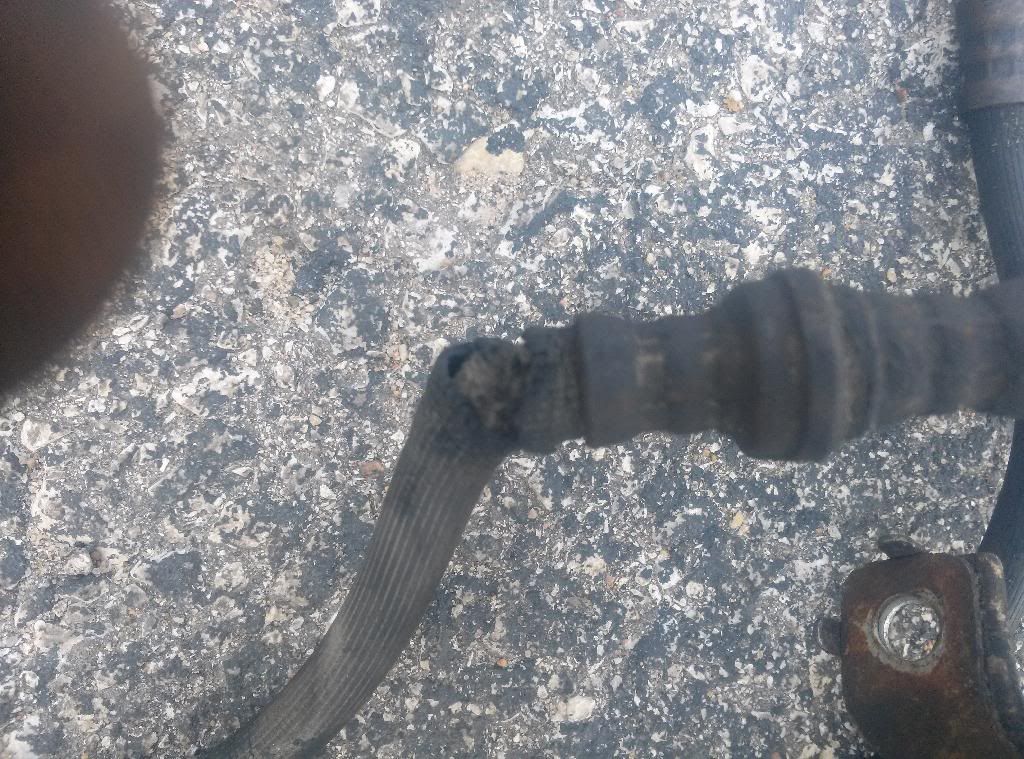

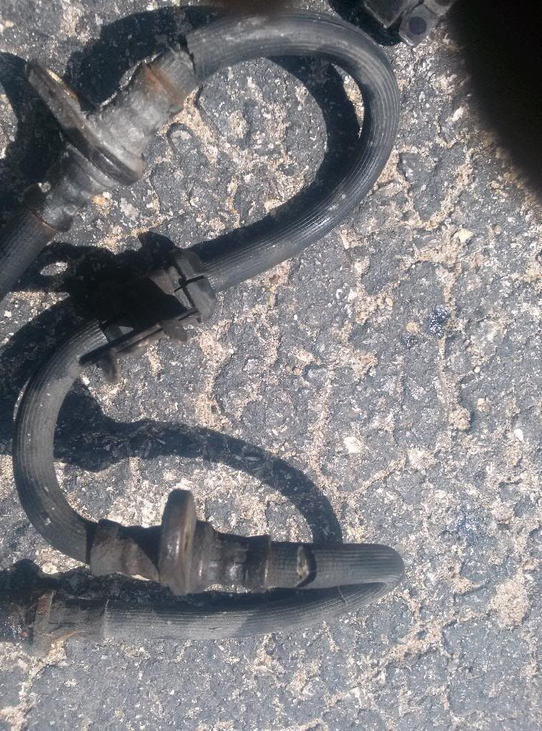

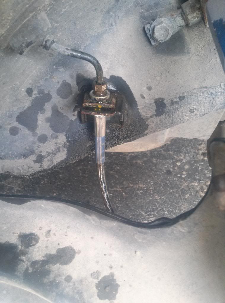

Brakelines replaced!!

Modified throttle body
